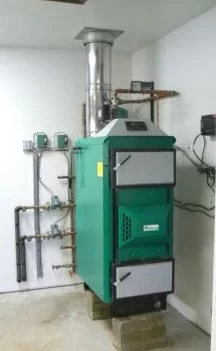

[Hearth.com] CENTRAL HEAT FROM WOOD, PELLETS, CORN OR COAL
Eko Hot Water Wood Boiler
