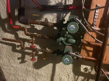

I've taken a few pictures, unfortunately I can't get far enough away at a good angle to get a picture straight on. Let me know if a different angle or a closer look at anything would help. Thanks!

Ok. This will be a complicated job full of many small, uncomplicated steps.
Before you start, find out how large of a system you actually need. Calculate the heat loss on your structure and size the system correctly. Don’t assume your current system is sized correctly. Too large of a system short cycles and breaks parts. This is what happened to my old boiler. It was breaking parts every year because it was way too big. As a home is updated, insulation added, windows and doors replaced, etc, the size of the heater needed goes down.
Using the system to heat your water will not be an issue. Some boilers have dedicated hot water hookups, some do not. Mine does not, but I put an indirect water tank on the side and run it off a zone.
Lastly, figure out if you want to keep the boiler in the same place. If you want to move it, now’s the time. Consider where the new exhaust and intakes will be located and their proximity to doors, windows and other things that may be in the way. Consider how the propane line will need to be run and any new electrical.
Are your zones set up correctly? Are the linear feet of emitters (slant fin radiators) balanced to the water temperature that you plan to use and the diameter of your feed pipes? Too small of a zone will cause short cycling and breaks parts.
So, this job could be as simple as slapping a new similar sized boiler in place of the old one and going with that. But that might not solve the issue of parts breaking. I encourage you to do some homework on your system and the needs of your home. You may come to the conclusion that the person that set up your prior system didn’t make the best choices and now is the time to fix the system.
Afraid I'm not going to be much help. What I see is something overly complicated that does not have to be! A gas boiler is likely going to be just as much problematic as the electric boiler!
The system that I have has one circulator for four zones. When a zone opens, a flow switch turns the electric boiler on . No flow, no boiler. The switch from wood to electric is manual and simple. Turn the boiler breakers on, open one ball valve and close one other. To go back to wood, just reverse the procedure! Good luck,
The Canadians don’t use zone valves like we do. They use circulators. It’s not bad, just different. I set my system up like OP’s system. I had a guy from Saskatchewan help me set up.
I had to have a guy come in to confirm a motherboard went on my boiler and had to explain my system. He told me he was glad that he was the guy that came out vs their Luger guy, who would probably have been lost, lol.
Here’s my zone control. I originally set it up with 3 zones.
Zone 1 is a 30g indirect water tank.
Zone 2 was floor 1. 3/4 inch line with 45k btu of emitters on it.
Zone 3 was upstairs with just over 20k BTU of emitters. I found the boiler was short cycling on zone 3. I ended up adding it to the beginning of zone 1. It effectively removes half the heat from water before it hits my first floor zone. The upstairs “zone”has a ball valve between where the water exits and re-enters to balance flow if needed, but it wasn’t necessary. I just send all the water up there. It stays a couple degrees cooler than downstairs, and that’s fine for us.
