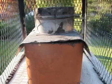

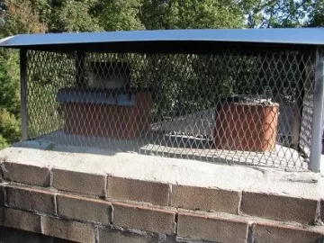

Ok, so some of you know my story. Well, I'm not gonna try and not let this beat me! Anyway #1, I'm an idiot. This is a pic of my chimney at the roof. The flue on the left is my stove in which the SS liner is not cemented in and can be removed. So first question, should I remove the SS liner and inspect it before I go any farther? I say this because when I had the stove out, I noticed 2 golf ball size dents in the SS liner about 2-3 ft above the stove. That concerns me somewhat. My gut feeling is to just get a new SS liner and start fresh.

Dents and scratches aren't a big deal as long as the integrity of the pipe is retained. If it has been smacked to the point you think it might have split the liner, I would sure be checking it out. If its just a dent - it shouldn't be a deal breaker.
Edit: I have no idea of how hard/easy it would be to pull the liner out, but if it is easy it might give you piece of mind to do so.
Can you fit the appropriate size brush down there without much trouble? Would be a good way to judge in my opinion.
Follow your gut. The way the rest of that install was done, ya just gotta know what condition that liner is in.

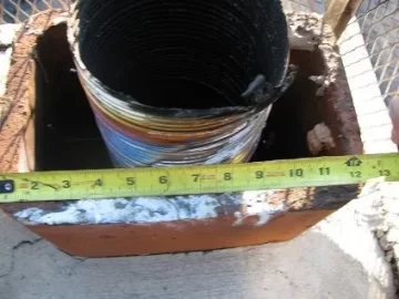

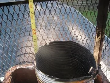

FRom the top of the SS liner termination cap to the top of my rain cap is only 3 inches, that seems too low to me??

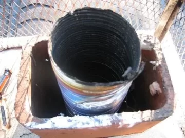

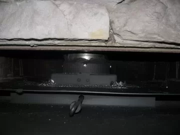

I also know one of my biggest jobs will be to install a block off plate. My lentel sits a few inches above my 30 degree elbow. Is there any reason a block off plate can't be installed at this heighth around this elbow? It's lower than most I've seen on here, but it would work in my application, thanks.

Do you know who did the install? It looks kinda rough at the top. You could fit a wrapped liner down that flue if you use the 1/4 insulation and the mesh, I hate to see you pull that thing out though, can you use a light to see if the dents are the only problem? By the way is that Freedom insert?
I have to ask, and don't be afraid to put this back in my lap if I am wrong. This is the first time seeing the topside. Why no cap on the clay pipe? That explains the fumes going up the flue. You need to get a stainless cap on that pipe or the heat is going to just head out and at some point, the rain may come in. Also, it looks like that liner could drop a few inches. With the correct angle elbow it looks like that might have solved the bad fit to the stove without an extension. If the liner is not trashed, it seems like this still might work, but perhaps I am missing something? You are there with eyes and hands on the front line.
3 inches to that cap seems tight to me too when I looked at it, but I supposed that cap that is mounted directly on my liner probably doesn't offer a whole lot more breath-ability if any.
For the cost of it, I'd pull it too. Pouring the insulation in is wise also. I would hate to see you pour insulation around a liner you didn't trust and be stuck with it.

There was a top plate BG. The nasty one in post #4.
He needs one that is sealed to the top of the flue tiles. Liner kit time.
Ugh, I thought that was the "before" picture.
