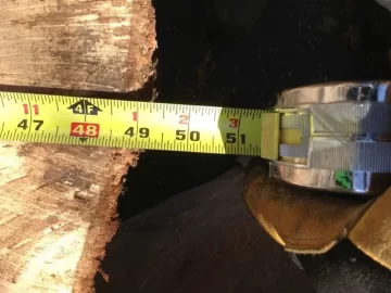

PSS- The Husky is 49" wide. The DHT is 46" wide. I need to be able to get it thu a 48" door.

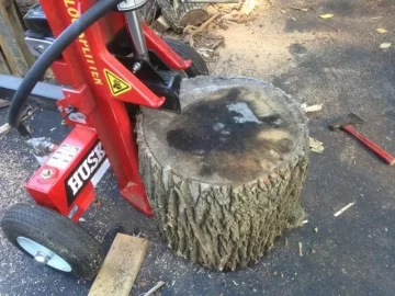

Oh... and have fun lifting these onto that DR.
Your pic motivated me to get out there and saw a couple logs tonight in anticipation of the next time I get my Huskee out, which will probably be once or twice more this year.
What does a Huskee do with that?
Actually, I don't know... those big rounds are oak, and I can't get 1500 lb. rounds onto the splitter, even vertically! The photo above is just a 24" diameter (250 lb.) branch round from a much larger ash tree. I did muscle a few of the 40" - 44" diameter x 20" long (700+ lb.) trunk rounds from that tree onto the splitter last fall, and it was very hard on both me and the splitter, so I resolved to just noodling anything that big anymore.
Still... point being... you're not going to put "little" 250 lb. rounds up on that DR splitter, without hating yourself in the morning.
I have 250 pound oak rounds. What I've been doing is muscling them onto their sides and using my big saw to cut them in two 125 pound pieces. The resulting splits will be much shorter, however, I can move the rounds to the splitter without hernia surgery, and I don't mind having shorties in the winter. Easier to fill cavities in the stove for overnight burns and when you want to pack full.

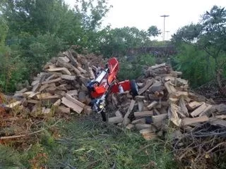

Here's an afternoon with the Huskee by myself. Some would say the hydraulic splitters are too slow, but I'm ok with this much output. If I had a helper to move the rounds to the splitter, I could have done twice this much maybe. Fatigue got to me.
How'd the splits get UNDER the wheels of your splitter?
How it happened was when I have rounds not seated properly, the ram pushes the log into the ground and lifts the splitter, and the surrounding pile slides under the splitter. That's where the helper would have been handy....keep the split would away from my splitter zone.
