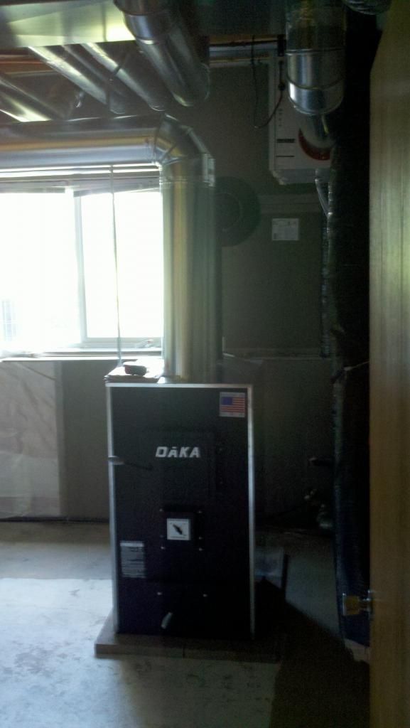

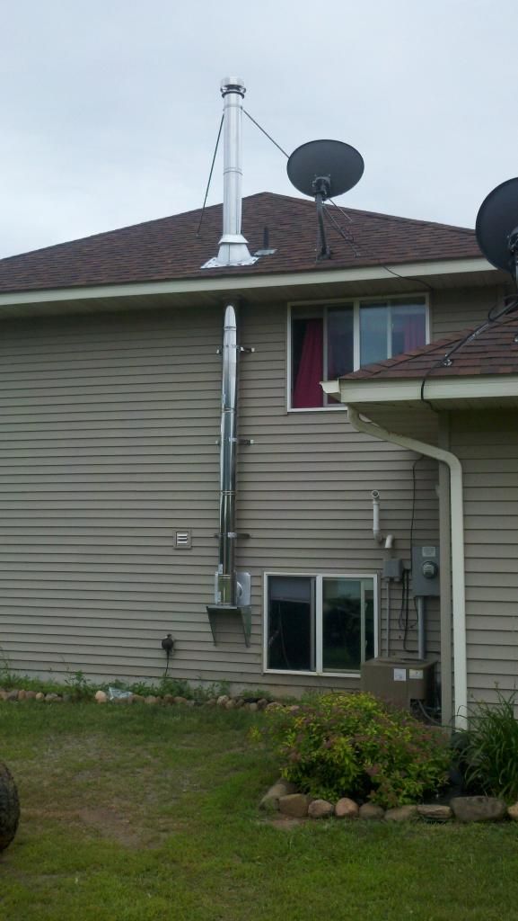

This summer I installed a Daka 521 fb (non epa) wood furnace add-on connected to our propane furnace plenum / duct work. The stove is setup with a single wall stove pipe, barometric damper that connects up to a through the wall 6" double wall supervent chimney. The chimney is about 23' tall.
The Stove:

Chimney:

With our setup we seem to have great draft with the current setup. The few break in fires we have had, we had no issues getting a good draft in the warmer weather. Stove pipe is around 500f - 600f with little effort and burning small amounts of poplar.

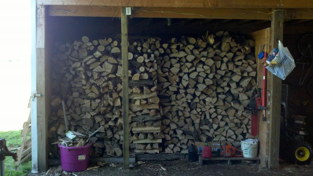

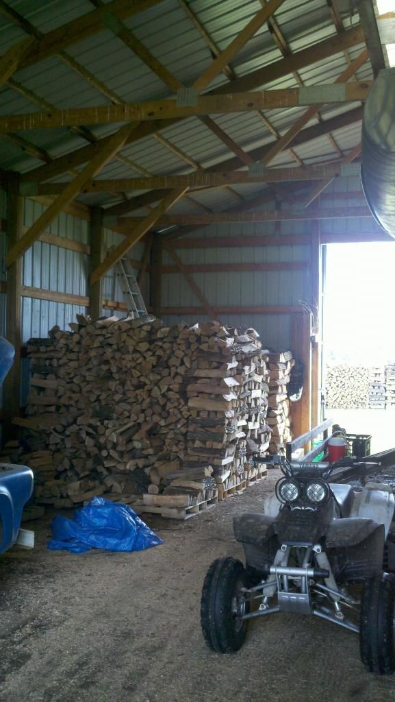

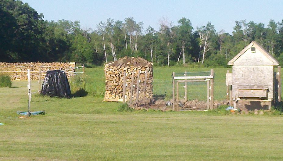

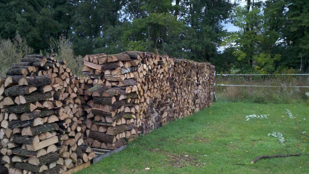

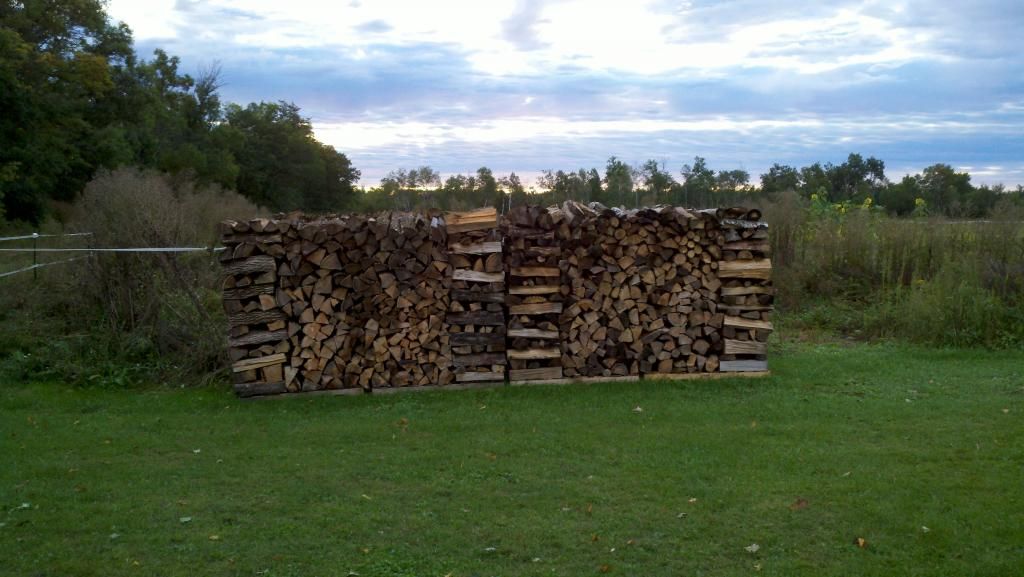

No offense, but most wood split last winter & spring, ain't gonna be ready. Some of the wood in your photos looks as though it is not ready.
Lastly, not a big deal, I hope, but you should have run the shingles over top of the roof base flashing so that only the bottom of the flashing is on top of the shingles & exposed.
You should be fine, just noting it as I was a roofer for many years.
