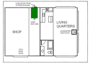

Also I drew up a quick sketch of the building and where I want the garn. And I agree with a few others that I do not want to store wood inside. To may critters/bugs to deal with. So I thought why not put the door out the side of the building for ease of storing and loading wood?
Only problem with that Idea is that the exhaust has to go some where. Can the exhaust be vertical instead of horizontal?

Also do you think it will be possible to install in the garn in the orientation in my sketch above?
I'm not sure how your winters are, but I would want that load door inside the building. Solves your venting problem as well without putting in an expensive chimney.

To answer some of your general questions, the GARN 1500 should be plenty big enough for your proposed use. Remember, a GARN is different from just about all other furnace designs because of its integrated storage. Since you will be using tubing in your slab, you can run the temp of the GARN down to 130 easily, and get maximum utilization of the water temp. With a GARN you burn more to recharge the storage than as a means of direct heating.
With the GARN located as you have in your drawing, you have an ideal setup to take advantage of any standby loss you may have. If the tank is shedding heat into the heated space, you have little waste.

The GARN is available with the vertical flue option, but I see no need for youto go that route. I would turn it around and load it from inside the shop area. You could even just turn it 90 degrees. You should be able to vent through a single 90 elbow without issues.

I'd be putting the loading door inside. It's gonna be COLD when you are making that Garn work the most.
Your right on the corn. Just is not as easily accessable and usable as wood. Just finding all kinds of alternative options I've never considered before has been educational for me.
As for the garn it may be an option to put it in its own room with wood storage. Off in the corner and vent it straight out. So, the heat loss on the garn is enough to heat 1000sq ft if left bare?
