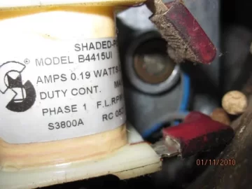

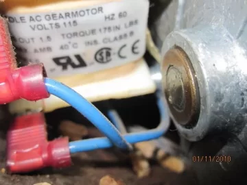

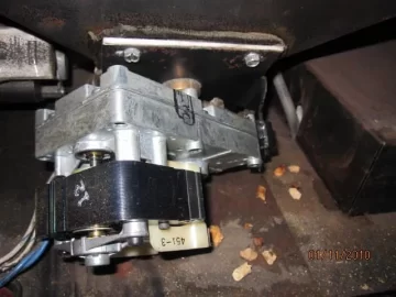

I took the back off the stove and took some pics for you that may help somehow,including the identification for the motor. See attachments(hopefully) . My motor is so hot that you cannot touch the frame of it so I would not say that is a true test. Before you toss this motor,I would finally check that the motor itself is free-as you know,it is geared down to give all of that torque ,but if you can take something to actually spin the motor itself to see if it is free,for it would take much less to hang it up and you could probably stop it with your finger, as it spins fast with little torque. Those motors have no moving electrical parts and are pretty tough,so you should really make sure it is toast before you move on with a new one. The easiest replacement is to get one from Drolet -S.B.I. unless you have lots of time to poke around locally. Be clear on shipping times however if you want it now. I have also replaced the burnpot on warranty -the previous one cracked and the new one is all steel,not stainless. Any other help..let me know.

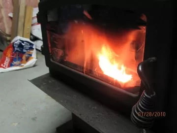

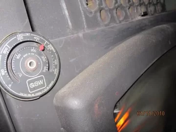

Jeff,here is a picture to help explain,but it is really really hard to take pictures of a fire,or at least I have not yet mastered it.I am trying to show how I have slowed down the draft by taking some of the sloppiness out of the draft control and letting the burn pot fill with ash. If you look closely,you will see that I have the flame heading towards the glass door. As a result,that blackness you see on the glass will wipe off very easily but the benefit overall is an increase in heat output(so much that the temperature on the "3" setting is now obtained at the "2" setting. I am going to see if I can adjust further. I feel this stove is overdriven in draft.
