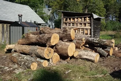

I think the biggest problem new owners have with gasifiers is that they don't understand what's involved in adequately drying their wood. Most people seem to think it's OK to cut their wood in the spring and burn it the following winter. I don't think it's possible to get wood dry enough doing it that way.
I cut my wood supply two years in advance, moving it into my barn in the spring before the heating season. So, it sits outside, cut, split and stacked but uncovered for a year, more or less, before being moved indoors to finish drying over the summer and fall.
With this approach, getting ahead of the game is going to require cutting twice as much wood as one usually would, far enough in advance. That's a daunting task for most people.
Does anyone else have success with a shorter timeframe?
I'm glad I don't sell gasifiers for a living but if I did, I'd build the cost of a cord of dry wood into the price, so the new owner would at least know what it's like to burn adequately dry wood.

I think its quite a bit shorter time frame for softwoods . The douglas fir im buning now has been felled about 18 months ago. Burns good,
No doubt. And, 18 months is a lot better than 6 months, which is what I think many people allot--at least until they get hip to the gasifier requirements. Some never do (get hip), and you can pick up their used boilers for cheap.

you should see the light go on in the eyes when they hear the proper gasification roar from some 15% wood.
I do make sure to explain to them that yes, they have to get 2 years ahead ideally, but from then on they're cutting half the wood as their old OWB, and that makes sense to them.

I would definitely split it as soon as it is cut to length.
Strongly second that. It won't dry out much when blocked. Way too little exposed surface area. That's beauty of split wood--that uneven surface really exposes a lot more wood to the atmosphere. I see people stacking large, unsplit rounds and I just shake my head in sorrow.

Thanks, I know that is preferable but logistically I can't split it an stack it where it is going to stay. Debating whether avoiding that extra move of split wood is worth the risk of it not being dry enough. I use about 7 cord so this is a case of moving all 7 cord once split (after it has already been split and stacked for a year. If I put up another building I am a dead man for sure!

Yes, I did about 5 cord last year of white pine by itself in a downdraft gasifier. As it says above, as long as it is dry it burns great - just not as many btu's per load so be prepared for shorter burn. This year I plan to use about 15% softwood mixed in the the hardwood.
What I've noticed burning softwoods is the Lower BTU stuff like balsom, spruce,pine is they sure seem to bridge a lot easier .. I just switched to fir a couple weeks ago and i'm liking it a lot better.
I had that problem at the beginning of last year (my 1st year at this), pieces were split too big and not dried enough. I have burned 7 or 8 cord of pine since last year, never had a bridging problem if it was dry. Even pieces with giant ugly knots got consumed into nothing along with everything else.
Got to remember that cutting a two year supply of wood is only a one-time event. After that, need to cut only a one year supply to be used in the 2nd year. I burn almost only pine (jack, white, red), plus a little mixed birch, ash, and maple, in my Tarm. This is now my 10th heating season with pine.
As to bridging with softwoods, although the bottom of the firebox in the Tarm is somewhat sloped down from the firebox walls to the nozzle slot, I have found that letting a large ash bed build up changes this more into a V shaped slope, further concentrates the coals towards the bottom of the V, and greatly reduces the chance of any bridging. Plus, keep the splits and rounds small diameter, especially for the first load or two of wood, after that larger splits can go on top or mixed into a wood load of smaller splits. Used to have somewhat frequent bridging issues, now near 0.
