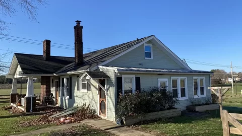

Draft wise I think it’s fine because I don’t have the issues Faithful Woodsman mentioned. I don’t have to crack any doors to get the fire going. But I’m attaching a pic of the chimney to see if there may be any issues with height or spacing from the apex of the roof. It’s 9x9 clay lined with 6” stove pipe going into it in the basement.

I’m having a chimney guy come out tomorrow to check the draft and take a look at things to see if I need a smaller/insulated liner.
