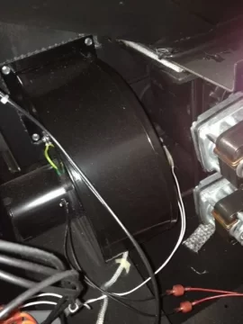

If its a PDV then it should like like the below pic. [Hearth.com] E-3 code Englander pellet stove

So yeah I did the trouble shooting with the settings on the panel and came to the conclusion that it is probably an issue with a convection blower cage block up, im just not sure the steps i should take to clean it out
The England web site has great how to guides. It's not difficult, just make sure that you keep track of where things came from and unplug the stove while you are working on it.
You will have to remove the convection blower form the stove in order to properly clean it.
To anyone that might be checking this thread out because you had a similar problem, cleaning out the convection blower worked like a charm and now the stove is working wonderfully!
