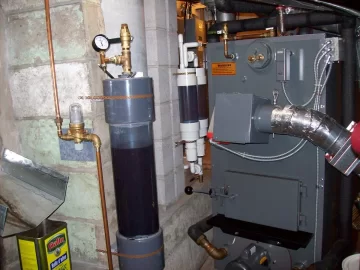

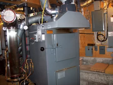

I have an stainless steel E100 for sale - used it for about 7 years. In excellent condition. Comes with factory vent hood, premium stainless insulated pipe to connect to chimney, a huge roll of premium square 2100*F door gasket AND custom professional moulds to make all your own refractory & replacement bricks (I used to do this for a living). Has a DHW built-in coil which I never used.
This is the most fantastic wood burner I have ever seen. I am heating a 2600 s/f house & 800 s/f separate garage through an underground line and also domestic hot water. Using pex in concrete, fan coil, and baseboards. When the temps are down to -10*C I use 4 - 5 split pieces per day, colder than that maybe up to 7 pieces maximum. We keep the house between 22*C - 24*C. It is installed in my basement, using outside air for burning. I am including a fire damper which I added to the air intake (visible in photo of back of e100). I could go on and on about this thing, but I'll stop here.
Health issues have caught up with us - we always cut and split & handled all our wood by hand from standing trees - just can't do it any more. The unit is currently still installed. I will sell reasonable - the only catch - I am in southern Ontario - near Oshawa.
Let me know if you might be interested.

It is a fair bit of work to make the molds as they need to be fairly precise and you need to be able to take them apart to get the finished pieces out, then put them together again precisely. I bought my refractory from an industrial boiler refractory company. Far better than the refractory that came with my boiler.
I changed the refractory design a bit so that the parts that wear could be replaced instead of replacing the entire refractory. Also I made the plug with a double seal instead of the factory single seal. My original factory refractory was junk after 3 years ?????? This was at the time Jeff was not owner any more. Wood Gun would not do anything for me so I made my own. I used the new refractory for 3 years - the heating performance of the boiler was no different than with the factory refractory.
With these molds you can make a batch of parts in about an hour.

I'm not a youtuber - all I have is photos but there are before and after. The pieces of old refractory in the photo was all that survived after 3 years of burning - the rest crumbled. I was going through wood gun factory center bricks every couple weeks. Initially I started making replacements by cutting and slotting wood stove fire bricks. Those were lasting a couple months. Before my refractory started getting too bad I started experimenting with lining the inside of the original wood gun center tube by shaping wood stove fire bricks.
That worked fairly well but the original refractory was still deteriorating where the center brick rests on the ledge. So the next logical step was to make my of molds. This is the result.
I have attached some photos of the molds. Also I have the patterns I made to make the molds. The refractory fits pretty much perfect - the tubes line up perfect, no shimming. Changing out any worn part is very easy as I made everything so it would come apart without using a hammer.
