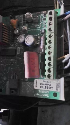

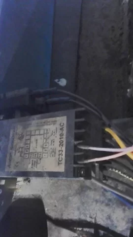

So can you post a picture of the controller you have?I would like to know if you still have the original or the newer one.I was looking at my notes of my fix this morning and they relate to the older controller.

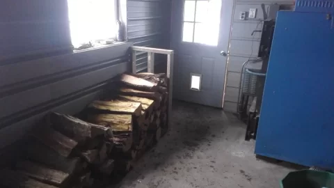

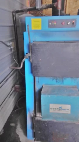

And here are the pictures I promised, hopefully I got the pictures of the controller that you want to see. I threw in pictures of the sheds because they were next on my tablet anyway

Hi Taylor
You have the old controller.The new one isn't a direct replacement,i had my electrician do the wiring.
