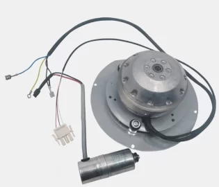

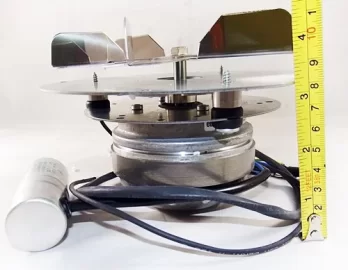

Concerning the exhaust fan, if it is turning too slow (maybe because of bad bearings, or a bad capacitor), then you would get the "EXTRACTOR REVS FAULT" alarm. The exhaust fan has an RPM sensor that tells the control board the actual RPM of the fan, and if it is more than 15% slower than what it should be (for the P level), than this alarm is triggered.
I'm pretty sure the draft fan is a shaded pole motor so no capacitor involved. Might have tight bearings but a drop of oil on the outer and inner bearings will cure that issue, if it is an issue............
No, the exhaust fan motor on the Ecoteck/Ravelli is a cap motor. Its an EBM Pabst ball-bearing motor, made in Germany.

Without sounding dumb.. Where is the capacitor? I don't see one and start or run capacitors are always mounted on the outside of the housing. Sure looks like an enclosed induction - repulshion motor to me. You might want to take that fancy die cast cover off and have a look see.
But then I don't have that appliance nor do I know about the mechanicals other than what I can see from your pictures.
.... and ball bearing motors succumb to the fine dust present in a stove. The waste products of combustion manifest themselves as a fine abrasive dust that eats bearings, ball, roller or bushing.
Pelleting is right, I fitted one of those a few years back and the capacitor is just hanging on to the harness, mine just lies loose on the bottom of the stove. But if the exhaust fan is faulty the stove would not be in 'work' mode : the feedback would raise an error.

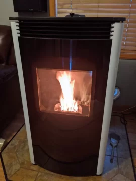

I actually just picked up a Harman allure50 to have something reliable. If I can fix this,not will be a spare. I will try the changes this weekend.
  • [Hearth.com] Ecoteck Elaina won't run
That Harman is an expensive stove....it is sorta an American version of your Ecoteck/Ravelli. How much was it?
They have really went up in cost (like everything else..lol). That cost twice what my appliance did 12 years ago.
Nice Allure, I actually went from a Ravelli to an Allure, Never had a problem with the Ravelli but the Allure is definitely an upgrade in many ways.
What is the upgrade features of the Allure versus your Ravelli?
The biggest one for me is the ability to hold temperatures. The ecoteck would burn me out, while the allure can maintain 70f with no issues.
Been running 4 days and no signs of needing any cleaning. The ecoteck would need a full vacuum by day 3. The allure looks to be able to go at least 1 month or longer.
The glass stays cleaner, it's quieter and has a 92lbs hopper which works better for my family.
