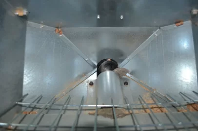

I installed a new Ecoteck Elena in late 2009. Stove has been flawless up until two days ago when I was awoken by "Pellets Finished" alarm, which was odd since the hopper was full. It turns out, the auger sounds like it is having trouble turning/labored. It essentially tries to turn for about a second, then stops. There is an error code for "Auger Blocked", but the fore-mentioned code was displaying instead. I inspected the auger up through the drop tube, cleared out any visible pellets I thought were jammed without avail. This evening I'm going to open up the unit. Questions: Has anybody had any issues with their auger and/or replaced one? Does anyone have the model # of the auger? Any information would be greatly appreciated.

Only way to be sure you found the problem is to empty the hopper, remove the auger motor AND pull the auger too. Check for a pellet jam....look up into the auger tube w/ a flashlight and make sure it looks clean. Maybe hook the auger motor to direct 120v ac (INSULATE THE WIRING!!!), to be sure it runs smoothly
I heard the OP found a rock (!!) that jammed his auger.....nice quality control from his pellet brand (Western Elite). Sounds like his auger motor survived this!
NJ is correct. The auger actually began grinding into the rock. Definitely a tough motor/auger. After removing the plate within the hopper that sits above the auger, I was able to dislodge the rock. Put everything back into the stove, back to normal operation. If there is a next time, I will begin by sucking out all pellets in the hopper first. Thanks for everyone's help. Below is the scenario. [Hearth.com] Ecoteck Elena auger issue
