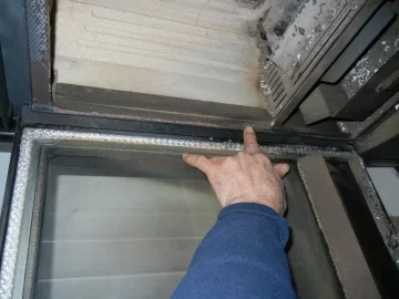

No I’ve never removed the firex when cleaning. The only screws or bolts I could find securing the Firex was a single one that holds the rear flame trap support and goes through the Firex most likely into the metal casting behind it. It appears to be one of the metric 8 as found on the inspection ports, however it’s no longer hex pretty much rounded. I can find nothing else holding the firex. I’m beginning to think that changing out the Firex may be a huge can of worms. Anybody got any suggestions????
Just inside of the door jam is the screws, four, high and low.[Hearth.com] Ecoteck Firex replacement

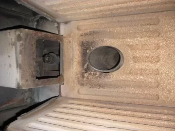

I think your Firex would be good for many more seasons. It is just some surface wear, I think it is about a half inch thick.
My Francesca does not have the metal channel as shown in Bioburner’s photo. Just the blunt end of the Firex exposed. I attempted a few easy tugs on it and it was very solid. Something Is holding it but I don’t know what. Maybe before next winter someone on this form will change out the Firex on a Francesca and post how they did it.

Just got some measurements of the Firex backwall and it is 1.2 inches thick. Should have wear for many years. Cleaned a lot of ash out which is really a good insulator. Weather has us stuck inside with snow and very cold.

When you open it up, look to see if there are screw holes along the metal door frame on the body of the stove (not on the door). While there is a difference between the Elena Air and the Elena in how the firex is secured at the front of the combustion chamber, they both have the metal strips. Are they missing on the Francesca or was it something added later due to potential breakage points?
