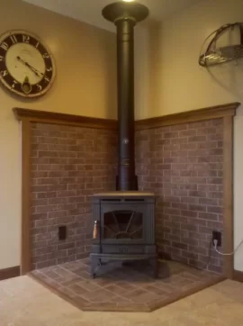

I have 2 outlets in the hearth area of my install. The wall they are in is 9.5 in. from the back corner of the stove. Clearance to combustibles from that corner is 9 in. so I just put a metal plate on the recep. and figure I am good. Is the recep closer than your specified clearance to combustibles?

I'm within an inch of specified clearance. Unfortunately the outlet is right off of the corner of the stove.
