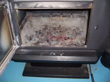

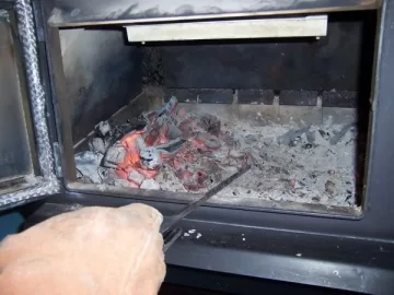

Welding gloves & long sleeve cotton shirt.
I rake the coals to one side & empty 1/2 the ashes.
Then rake the coals to the cleaned side & empty the other 1/2

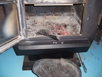

Every movement is slow so not to spill & make dust, don't dump ashes of the shovel,
slide them in the bucket so the don't have any distances to fall of the shovel to make less dust.
Scoop a shovel full pause 2 seconds with the shovel full still inside the stove to let the dust go up with the draft, then slow to the bucket.

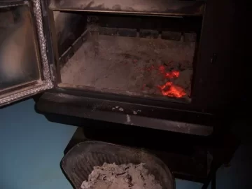

Spread the hot coal around & reload with dry firewood. Stove up & running in short order :)

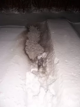

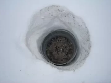

Empty the ashes in the garden between the raised beds.

Good thread Dave. The only thing I do differently is I dont fill the shovel. I also keep the bucket up against the doorway so that any dust will be pulled back into the stove. But if its hot enuff that can be counteractive.

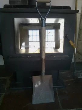

I do the same thing but use a bigger shovel :)

Dave has a few feet of snow. He should be ok. Raining here all day so I scattered them over the garden.
Dave is that creosote in the corners of your stove,I get the same thing but then after a hot burn it goes away.

I do the same except I turn my coal hod 180° so that there is more room for the shovel handle.

I was tipping the bucket until I got some ashes in it, but that's a good idea.
Next time I'll try it.

I empty right away either in a burn if no snow, garden if snow or raining.

Yea, creo, was burning "long & low" with the warmer weather for 3 days. Now cold again.

Hope i never have that much snow, same would happen since I couldn't get to the garden. :lol:
