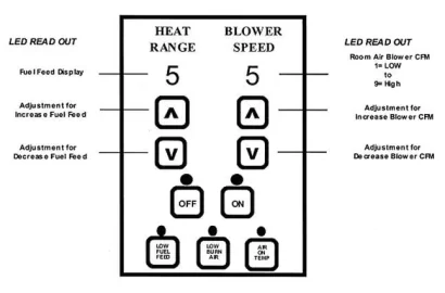

There are no buttons labled "Room Air Temp" on the control panel of a 25 PDVC.
Like Imac said above, I have never heard of a U code either.
