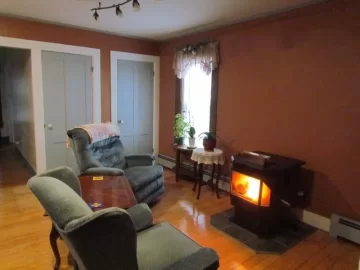

Thanks for the info given above. At least it is some progress in understanding the details. Knowing that "low" refers to levels 1 and 2 is useful. Yesterday I received a Skytech 3301P2 wireless thermostat and got that installed. Had I not known what "low" is, and had I not known that when it switches to "low", it affects only the pellet feed and not the blower, I would have been convinced it was not working. But thanks to these fora, I was able to figure things out. My stove is running well, I think. I'm waiting for some colder weather to find out what it is capable of. We have 1600 feet on two floors. I bought some grates to put in a register to allow more heat to get upstairs, but I have not put those in yet. Lake girl said we should have pictures, so here is what my room looks like - there used to be a door to the outside where the stove is now.

Before cutting holes in ceiling/floor, you should check with your local building inspector. Building code problems...
Edit: Nice looking set-up. Color of your walls is the same as my son's bedroom;) Hope you have surge protection on your stove...
I've heard from a couple on line here, that such grates would likely be against building code, and give a stove fire an immediate chimney or path to get to the next floor. I understand that .. but then again ... so does my stairway .. which IS code.
I can't attest to the grates being code in your area or not.
Pellet stoves don't give of as much heat as a wood stove, that would likely really help the 2nd floor with grates!
Looks like your stove is a great 'anchor' / center of attention for your room! Looks good!
Thanks! Other than the stove, a new ceiling, new lighting, new walls, and a refinished floor, it's just like it use to be! ;)
It would be ironic if the heat register is against code. When I tore out the old ceiling, there is evidence that there used to be two of them in this room (house was built around 1850), so I would be restoring what used to be there. I will have to check on that. I read about protecting the electronics a couple of months ago and happened to see an outlet with sensitive surge protection built in on clearance at Home Depot, so when I put the new wall in behind the stove, I wired in that outlet.
