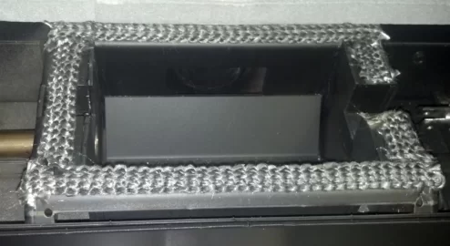

Dexter and I sealed the burnpots with the flat ashcan gasket, and it made a nice improvement. The pic below is courtesy of Dexter, but mine looked almost identical.
The advantage you have is that you can seal completely around the cradle, since you don't have a stirrer cutout to deal with.

Yeah. I prefer to seal the pot also.

I started out by straightening, then sealing the pot to the cradle. This did make a marked improvement, however, I was still cleaning the burn pot every 2 days. The clinkers were huge. I modified the burn pot by welding the top row of holes, I saw a little improvement. I went to Barefoot pellets and I saw a small difference. At this point I figured it was worth a shot restricting the airwash slightly. Now the stove runs flawlessly. I don't touch the burnpot for days. Ash is being blown into the ashtray like it never did before. I checked for gasket leaks before I did the mod. I had one small leak by the handle. Once the season is through, I will be replacing all of the gaskets and the blower motors.

I should have updated again. Over the summer I bought all new gaskets and blower motors. After the rebuild, my stove burns even hotter and I opened my airwash back up. My settings are 1, 4, 1 and I only vacuum the ash once per week. I certainly had some air leaks which was why my burnpot was getting dirty.

Other things I found with my stove...... check all of your sealing surfaces using the "dollar bill" method or trace around your gaskets with a grill lighter while its running. I had significant issues around my cleanout tray.

Adjusting the low burn air as high as I did just put a lot of heat up the exhaust. I can send you pics of the mods I did to correct my air leaks. Also consider Brushing the baffle behind the ash tray. There are 2 plates that get removed. Get a long flexible brush and clean it really well. That seems to make a big difference. I bought my stove used too. The previous owner never really cleaned it and it didnt run well at first. Now its great.
