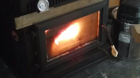

1. very poor customer support. ok dvd and documentation but have only spoken to mfr once after I gave up on calling and emailed them. now my emails go unanswered.
2. unit is about a month old and in that time I've been disappointed in its performance( as in btu production). thought I'd b doing a lot of sweating as some of my friends report. here is the rest of my story:
a. have used predominantly green supreme. tried a few other brands with similar results-firebox when it on mode tends to b in the 425 area with hot air blowing off the unit in the 150 area. disturbed about the inefficiency of the heat loss. did see a significant uptick in temp with natures own pellet from tractor supply but they don't carry it now. I sit a heavy piece of metal stock on the door and rest it against the vents to try to capture more heat and send it into the room area.
b. unit operates with a remote in on off mode with a 1 degree swing. set at 72 and unit correctly cuts out at 73 but doesn't seem to kick on at 71. I often see room temps of 68. maybe it is on at 71 but takes some time to raise the rooms temp up to setting.
c. use about a bag a day but of late ,a little more than a week, experiencing sooting of the glass predominantly around the hinged portion and the bottom. the firebox is blackened too. notice smoke leaving the vent pipe up the masonry 3" flue liner to the roof which I don't think occurred prior.
d. fire is yellowish for the first 3-5 inches then seems to orange up as it licks the bottom of the heat exchanger. upped the low air setting from 4 to 6 to c if I could make the fire hotter and taller. just a wee bit of bigness change really. nothing dramatic
e. if I really squeeze the door shut, I get a miniscule improvement but nothing significant. thinking maybe something minor with the gasket. bought a new one but haven't installed yet since unit is so new.
that's about it. looking for input to c if I can rid myself of sooting and get unit to perform better if that's a doable.

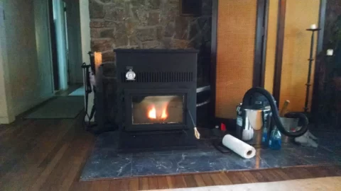

my setup in the living room is pretty straight forward. the unit is vent piped with 3" dbl wall for about 7' till it enters a flex steel single wall flue which goes the rest of the way up my fireplace chimney which is about 15' more of upward travel. the air enters also from the masonry flue. mine is 12". a masked 3" alum duct into 2" one which was supplied by the mfr. maybe 4' in toto.
must say that in the early going with settings at 1,4,1 and even full out at 9,9. the unit didn't push out enough heat but did not create any soot. just fly ash. also forgot to mention that I ringed the outside of the door glass with fiberglass to make sure it wasn't leaking fresh air there.

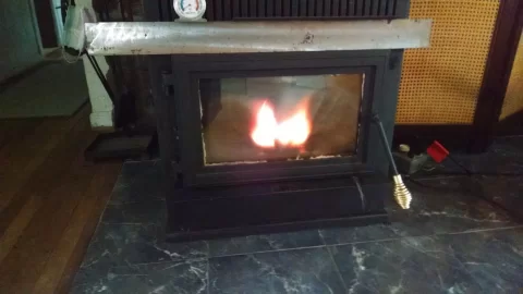

here's where I b as of now. unit cleaned of major soot issue. disassembled 7' of vent pipe to 3" flex vent connector. lots of sooted up ash. brushed and ash vac'd. leaf blower would have b done in living room tee clean out but I can't seem to find the attachments to make the blower into a vac. vac'd out end of combustion fan as best I could. do not have a gasket for it so wouldn't disassemble same.
unit set on mode 3 and 1,6,1. its controlled with remote set for 73 with a 1 degree swing on the on and off pattern.it didn't take much but less than an hr for the firebox to reach 450 and the air off the vents at 150. [Hearth.com] englander 25 pah issues
the flame is pretty good but I think still a little weak nearest the heat exchanger. the unit in little over an hr is showing 460 on the firebox and 165 at the air vent. you can c once again that mr soot is forming on the left corner hinge side. it will I expect continue to expand down and toward the handle side, leaving a u shaped unsooted portion in the center which will covered with fly ash after 24 hrs of continuous operation. also, still see some smoke not too much exiting the flue at the top of the roof. think this means that the burn can b improved upon. have 3 bags of another brand of pellet. just might throw them in to evaluate performance.
then the only 2 things left for me to try are replacing the door gasket and cleaning out the combustion fan but I'm getting pretty well p****d off already and thinking since I'm leaving 1/1, might just as well use it as best I can till I leave. then return it for full refund with whatever pellets I have and do the best I can with my wood stove alone when I return to ny from fla end of march.
really disappointed in this unit. can't fathom why a 450 firebox only produces a 150 current of air. where are the 300 degrees going??? thought of placing some 1/4" flat stock into each of the vents slots and c if I can capture more heat. still haven't. just can't c myself struggling some more and still coming up short so to speak.

when I installed the oak it was a foot or more away from the flex pipe. they're both in the masonry flue and quite separate. I'll check the mesh at its end tomorrow to c if its clean or cluttered with debris.

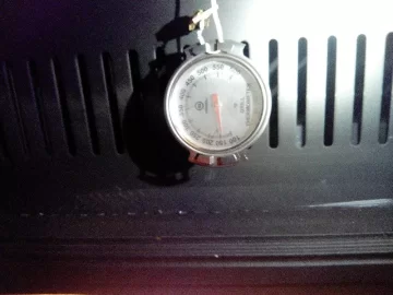

well, my temps show a 450/+or - on the firebox with a simple wood stove thermometer. then I get a rather disappointing 150 heat coming off the air as it exits the louvers. you need to start measuring your performance. its cheap under 10 dollars or a bit more..but where is my 300 degrees going?????smokey thinks I need to look at the air intake. maybe its smothered with debris in the chimney flue. don't thing so. but my flame is not what I'd like. my friends harmans insert burns like a 4th of july fireworks. mine is more like boy scout hot dog event. his flame shoots high like 18" and is straight up like a tower of sparks. nothing like what we have. but obviously his unit is 2.5 times ours in cost. still I was hoping for a better result....

Well I do measure with an IR gun plus I leave a magnetic thermometer on the hottest point on the side of the stove. I've never worried about the air temp since that will change with your blower speed and seem counter-intuitive (you could see the actual temperature decrease even if the heat output increases as you increase the blower speed for example). But for the heck of it I strung up a grill surface temp gauge in front of the louvers about an inch air gap to make sure heat isn't conducting through the metal (like 400 degrees right below the louvers). I get about 140-145ºF with the heat/blower set at 4-9 (and factory bottom three settings). Acammer - at what heat settings is your 180-210? You gave the bottom 3 but not the main settings. I assume 9? But yours may read high if its directly touching the metal I would think. I was getting about 215º on the metal between the slots, and of course right below the slot it jumps a couple hundred degrees quickly. I'll run it up to 9 later and check it, but my living room was nearly 80 degrees even with this on 4 yesterday (was in high 30's and low 40's yesterday here).

it seems when my unit is running more properly I'm showing the same temps on my oven kitchen stove hanging over the louvers as you. sometimes I get it almost to 170 when the firebox is approaching 475 as measured on the left side as you do with a wood stove thermometer. the remote is set to keep the main area around 70 and it does that for what I would say is 15 hrs then with the build up of soot and inefficient burning the temps go down. the firebox running at 300 and the air at maybe 110. btw, I balance a heavy piece of metal on the door to radiate up more heat. that's the silver bar in the photo below the oven thermometer.
where I'm at now: unit on mode 3-settings 1,6,1 ran for about 15hrs before sooty burning is slowing it down.

I'm after the oak this morning. will remove the sock over the end hoping as smokey has suggested, leaving it open will allow more fresh air to b drawn into the unit and result in optimum combustion. when the unit is cool enough will try the dollar test too.
as you can see from the above pix this morning after about 15 hrs of continuous burn the glass is most sooted up with a small ashy center pattern like a u. heat production low and combustion low temp as well.
