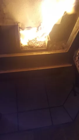

so recently my englander seems to burning all types of pellets super HOT, usually turned on 1:1 itll still get the house to about 80 when its 20 outside. and the pellets pile up into a big solid brick, iv always had that problem. i just have to break it up often. i know more blower, iv plqyed with the air with similar results. im new to pellet stoves so just unsure if this is how they are? seems like i dont have any control anymore. iv tried 80/20 mix all hardwood, all softwood. and same results all around. i like green team, inferno, and maines choice is REALLY hot burning. maybe something broken with the ECU? its roughly 6 year old stove and i clean it pretty much everyday cause thats just me.

yes i clean everywheres take the plate out. i know it does need a gasket change, but nothing that is that bad just prob should be done. cleaning wise iv take burn pot comoletely out once and banged all the ash buildup out of the inside of airflow in the pot itself, replaced that gasket. cleaned it in and out. it only piles up when i cant break it up during the night. its seems like it just keepa feeding the same amount of pellets all the timem how do you reset the board? it has had startup errors before but as i said one thing i know is its clean as a whistle in and out! it was professionaly installed my house is 5 years old, my scond winter here and seems its always been this way, but somethings not working right!
been burning like this all day. these pellets ate alittle more ashy then normal ones i use.
