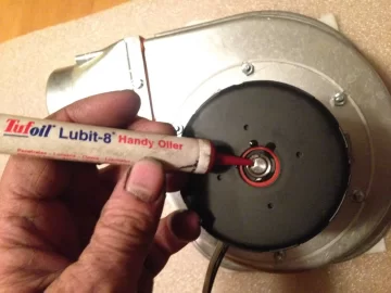

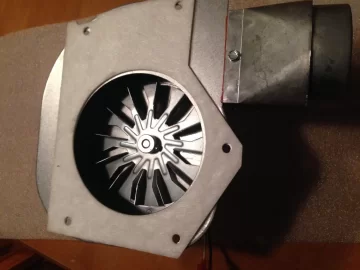

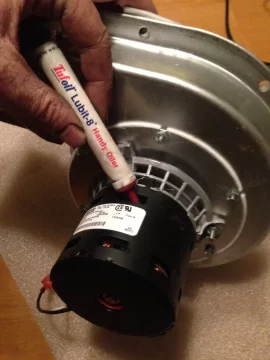

You can use light oil to lubricate this blower.
2 drops on the end of the shaft and 2 drops on the shaft. Try it to see if it quiets down. See my pics

Don, thanks for the feedback. Great pics btw. It is possible to "repack" this type of bearing but often you can do more harm than good. I did put a few drops of oil on the outer bearing last night to no avail. I didn't get the inner one yet.

They look like sleeve bearings, Don, right? Impregnated bronze would be my guess so entirely possible to lube. I'm sitting here thinking of the tube of door lock oil I have that is loaded with graphite. I bet that would work!
http://www.walmart.com/ip/19866156?...70991156&wl4=&wl5=pla&wl6=50564021196&veh=sem
Yes, they are sleeved bearings but they do not easily come apart like car wheel bearings so it may be heard to get in there.
Certainly Worth a try before you junk the blower!
The stuff I referenced is a penetrating oil too so it IS worth a try. When I got the new one, that's the first thing I would do also. If it's making noises, the shaft is probably flopping around in the torn-up, ovalized bearings so it's only a matter of time!
