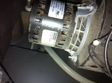

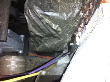

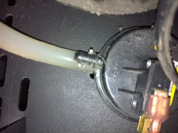

Looked at the vacuum switch going into the combustion blower and it doesn't seem quite 100% attached (pic below) not sure if when it heats up this could be the cause?

No....that's not the correct vacuum switch...there should be two of them in your stove, it's the other one. I posted a wiring diagram in the previous post
And yes, make sure the combustion vacuum hose is attached firmly too.....you can take that hose off too and make sure that hole is not clogged.
If you look to the right at the top of the burnpot, there is a hole. Make sure this is free of ash and unclogged....

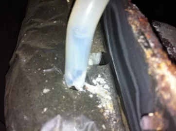

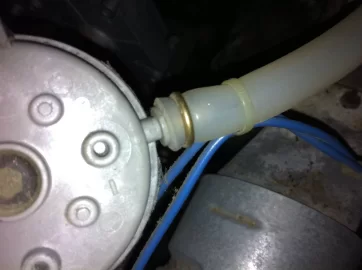

OK, here's the other one. Do I need to take out the convection blower to get to it? I can't see how it is connected to the front of the stove and if it would just pull off
