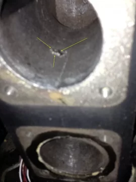

Well the 3 hour operation was finally successfull! During auger re-assembly the top auger free hand spin check revealed a snag on every 360 deg turn!
So I had to remove it and the pic below shows one problem on the inside bottom of the top auger chute close to the back of the stove.
There were also 3 more pimple type burrs way back inside the top auger chute on the right side!

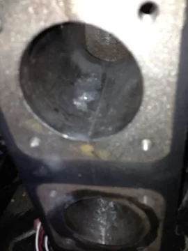

All pimples and burrs had to be vigorously ground down with the grinding stone.
Then Dry Moly Spray was used to make the pellets really slide!
Pic 1 - Shows before grinding - see yellow arrows of welding slag mutation!
Pic 2 - Shows after grinding

Were they welding slag? Kinda looks like it from the photo.
Yes, and took alot to grind down!

It was a stove I repaired where the top auger was completely jammed. The pellets in it were good pellets and very little fines. The stove was in a very dry basement. When I turned the auger by hand with NO pellets and NO motor connected it did NOT turn freely. This stove was inherited in this state so the original owner could not be questioned about the history. It was just abandoned when the house was sold. Looks to me that it probably never worked that well in that state. Maybe the fact that there were also approx 200 bags of very good pellets left with the stove means the original owner was not very satisfied!
Another mystery is that after I fixed it good, the fire was too low. I found that the 1st of the 3 bottom buttons was set to 1 ! ! !
This is the LFF Low Fuel Feed. Therefore I believe it was turned way down in a futal attempt to keep the auger from binding. Probably jammed up easily on the higher heat settings.
