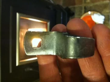

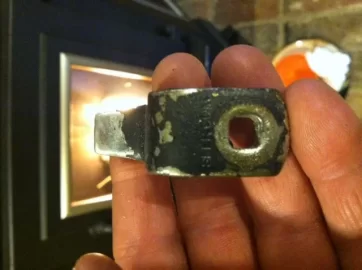

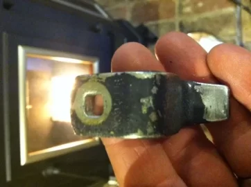

Today while running my stove (purchased Oct 2014), I heard a sound of something dropping. Upon looking through the glass I noticed a metal piece on my lower auger.
I have no clue how this got in there since I just cleaned it a couple hrs prior.
Would anyone be able to let me know what this piece is? The stove appears to be running fine, blower, motor, both augers working as they have been the last few months since purchasing.
Thanks in advance!

Hey Smokey...I agree it looks like a latch too. Shy of re-shutting down the stove I can't see where the latch would come from. What puzzles me is that it was in the lower auger area when I found it. I'm not sure of any latches at the top of the inside part of the stove.
Figured it out! Looks like it is the right lid latch. I'm not sure how it got in the lower auger, but I'm happy I was hear to catch that before it caused any damage.
Thanks Smokey for your input since it led to the solution!
It came down via the auger system in all likely hood, you might want to find the rest of it.
I did find a washer that was holding onto it too..I'm surprised that the latch was able to fit down that system. Your right thought I should track down all the pieces...

OK, you need to find two nuts and one lock washer.
thats the hopper latch alright. i cannot believe it passed through both augers with no issues!!!
