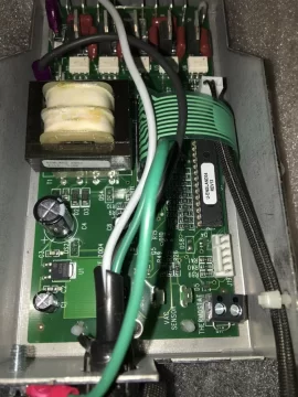

If the jumper is not on the T-stat screw terminals on the back of the control panel in the lower right corner then the stove will burn on the Low setting no matter what the heat level is set to.
See bare jumper wire in pic below.
Click pic to enlarge:
