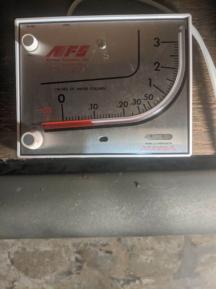

I've checked the draft with a dwyer mark II and it's reading -.06, and Ive seen up to -.10" (The manual says don't have it over -.06, but shut all the way down it still snuffs out the fire).

So I think I'm going to keep an eye mainly on my chimney temp, I think something is off with my Dwyer manometer, as the damper does not change the reading any noticeable amount... More tinkering needed.

Have you checked zero on the Dwyer lately?

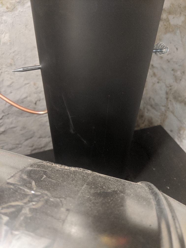

Have a pic of your Dwyer setup, how its hooked up and all?

Ok: afternoon update! So I had a fire this morning, loaded at 8am - left the damper open, loaded 6 splits - fire was out and down to just a bed of coals in the back at about 12. Reloaded, this time closed the damper all the way, and played with it for a second (more on that later). Stove is now 2 hours in, much better secondaries, same or better heat, same number of splits and it looks like it's barely into the fire... Interested to see how long this one lasts.
Ok so in playing with the damper I noticed that it DOES make a difference in the manometer... About a .02-.03 drop when it is closed.
So open it was reading .11 (pipe at 350 surface) closed it came down to .085. This is still over the .6 max called for in the manual, but better than .11. when it's cruising
I calibrate it to 0 before each time I plan to use it. It's a pretty temporary setup with what I had on hand but I figure it should work.
So here's where I'm at: I had a hard time believing that my draft could be as high as what it's measuring because... It's an outdoor masonry chimney that I added 22' of insulated stainless liner, into a T, through the stone foundation and then a 90 down to the stove.
Based on today's tests so far it's becoming clear to me that I should trust what the manometer is reading... And even with the flue damper, I'm still over draft. I'm thinking a barometric damper may be in my future.

Haven't seen it so not sure, but you might be able to swap a 90 for a T and put a baro in that, to get your draft in spec. But I'm not seeing anything wrong with your temps.
