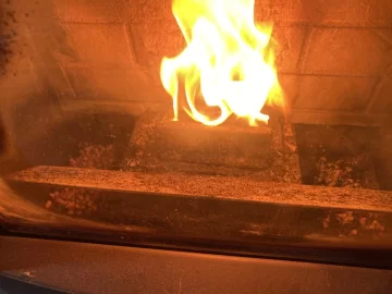

I have this stove for a while now . I do not remember the pot filling up like this with in 7 hours. You can see the pellets bouncing out, I was think to drill out any holes in pot that may not be correct size

That's always a good idea. I don't know that I'd worry about any holes around the top as they seem to be more for air wash.
