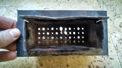

On the 2nd year with my Englander IP and my last cleaning revealed an unhappy burn pot. Hopefully the pictures show what the problem is, got some perforation between some of the holes in the bottom and some warping. I've noticed the warping for a while, but the holes are newly observed.
Obviously I need to order a new one, but I'm wondering if there's a problem here. I don't think it's normal to go through a burn pot in 1.5 heating seasons.

I've been seeing some increased buildup in the pot with this year's batch of pellets and I have a suspicion that that has caused the bottom of the pot to "bake" under a thick layer of ash that may be the cause, but hoping to tap some of the insight here (hey @stoveguy2esw :) ) if that's a reasonable conclusion. It's been pretty cold and I haven't turned the oil on, so the stove has been working pretty hard.
I've ramped up my cleaning a bit to keep the burn pot buildup under control, so I'm hopeful that will address the issue in the short term.

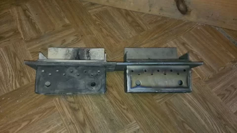

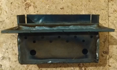

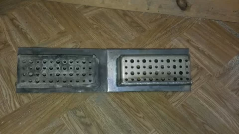

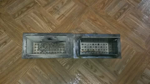

Here is another update with some interesting findings. I received my new burn pot and convection blower Thursday morning. I gotta say, that's good service, warranty claim on Monday night, new parts Thursday morning. I decided that I'd do some comparison on the original burn pot to the replacement pot, and then see what performance differences I noticed. I've attached a couple of pictures and I'll share what I see here. Overall they are very similar, holes are punched in the same pattern, same number of holes. The old pot is just slightly deeper overall. The holes on the new pot are just slightly larger (1/16"-1/32") at every hole. I'm not sure how to account for this, other than maybe my original pot was punched out when the punch was very worn, and this new pot had a fresh punch that yielded larger holes. 1/16" doesn't seem like a lot, but times something like 60 holes and that's not insignificant.
Once I light the stove up with the new pot I learned this new pot definitely runs leaner than the old pot. Previously on the highest heat setting, with the Low Base Air maxxed out at 9 I could run the Low Fuel Feed trim at a 3-4 and maintain a clean burn. With this new pot I can run the Low Fuel Feed trimmed up to 5-7 with a clean burn. I didn't leave it on 7 because I was heading out of the house for a few hours and couldn't watch it, but it's been running on 5 now for about 12 hours and shows no signs of building up at all. Glass is still clean (well, no black soot, only ash) and I'm still getting lean surges (where the fire burns down below the top of the pot) so it looks like it'll tolerate trimming to 5 well, I'll probably try 6 tomorrow and see if it'll take that.
I also noticed that my old burn pot must have been bleeding a little air around the edges of the pot - it would always push the ash away from those edges. It was just a tiny bit, but I always wondered if just a little air was escaping there. With this new pot I get none of that, ash lays right over that edge of the burn pot to the cradle without any pushing away. So, all in all it looks like this new pot definitely performs better than the old one, which is exciting to say the least. I'll probably clean up the old pot and see if I can do some small touch ups to the holes and get it breathing how it should. It would be nice to have one I can have soaking while the other is running, for easy clean ups.

Glad to hear that you've found the root of the issue and that it's cleared up your problems. Do us here a favor and report back if you find any significant differences between your old burn pot and your new one. I'm still blow away at the difference I've experienced with my new burn pot. I believe the combination of better sealing around the pot and just slightly enlarged holes has provided me with a much cleaner burn. On my old burn pot, I can run for about 24hrs on the max heat level setting with the LFF trimmed to 3 before I start to get build-up and a degrading burn that requires attention. With the new pot, I can run for 48hrs+ (I stopped my test there and did my standard clean-up) with the LFF trimmed to 6 and I still had a clean burn, althought I think I was right about to the point where it was going to start to turn dirty. I can probably trim the fuel up to 7 and go 24hrs, that'll be my next test. It's important to me to get that stove as hot as I can, as it's servicing my whole home essentially. The difference in the stock trim setting to a setting of 6 is nearly 40*F output, as measured by a magnetic "stove temp" thermometer at the exit of the heat exchanger. In real world terms, it's the difference between being able to sustain the house at 15*F ambient outside vs 25*F outside.

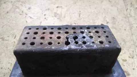

Here's a picture of my parent's dirty burnpot out of their IP. It has started to split in the front.

Geez! Do you know what year that stove is? I'm just wondering if there was a bad batch of metal along the way. My original burn pot with the metal failure was circa 2011. We'll see how my 2014 pot holds up.
Mine has gotten thin in the same spot, it seems to be where the main body of the flame hits that guard, or maybe pellets hit it as they drop and that adds up over time?

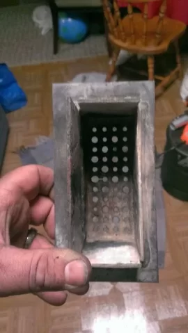

Well, got the new pot today, and it's different. The skirt on the front does not extend up past the sides. That's different than what I have now, and what everyone here has posted, included the recent warranty replacement by @acammer. Not sure what to make of that.
[Hearth.com] Englander IP burn pot degrading
I measured the steel thickness with calipers and I get about 0.117" for the pot body, which looks to be 11 gauge. The pot flange is 0.172", which is around 7 gauge.
The holes in the bottom do look a bit bigger. The larger are 0.248" and the smaller are .172"
Haven't shut down to swap it out yet, but will update with info from the old pot when I do.
Interesting. I see on their website that the do have two versions - on that matches the one I received, and one that looks like what you have. I"m not sure what the difference there is, I'm guess it has something to do with directing the flame up and away from the glass, but that's speculation. Definitely let us know how she burns with the new pot. I'm still overjoyed with the performance I have now - I've been able to increase my output significantly, and I can go two days between cleanups, probably longer but I like to keep it tip top. I'm going to weld up the old pot and do some tinkering with airflow next season once this stove goes out of warranty. If I could get both pots to perform the same it would make clean-ups a snap.
