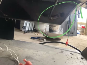

The only wire that goes to or looks anything like a braided wire goes to the blower housing and appears to be some kind of sensor.
