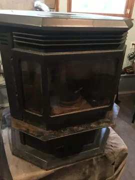

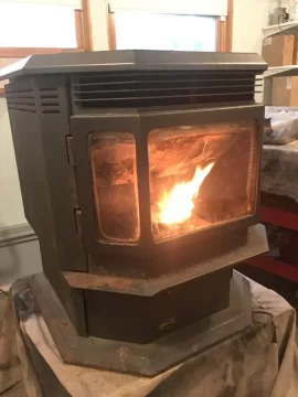

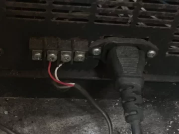

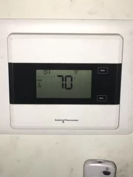

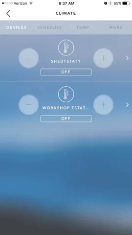

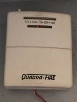

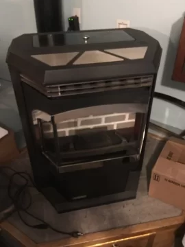

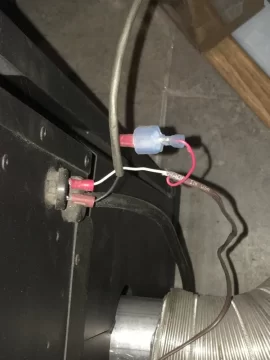

Would be interesting to see how they accomplish the on board thermostat. Harman stoves too have a built in temperature system but have a room probe that extends away from stove.
Hello
The Quad CB1200 has T-Stat screw terminals in the back of the stove. See 1st 3 pics
The Harman must have the T-Stat wired in series with one leg of the room sensing probe. See rest of the pics Harman is on the Lowes Iris WiFi T-Stat using an iPhone 6 plus

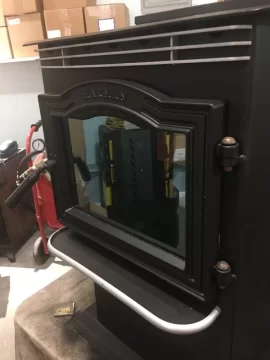

Don't you really Have to Have a Harman!
Here is a Harman P61a in great condition that puts out a whopping 61,000 BTUs for only $2250 !!!
The top and sides get hot like a wood stove!!
There is no better stove for this money $$
(broken link removed to https://nh.craigslist.org/hsh/d/harman-p61a-pellet-stove/6247256342.html)
I got the hopper extension for mine and it holds 2.5 bags!
I also got the Nickel Trim Kit and the scenic tile, now I want the mirror glass for the fire door. :)
Attached is a pic of Harman with German Engineered mirror glass!

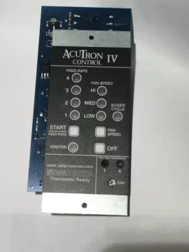

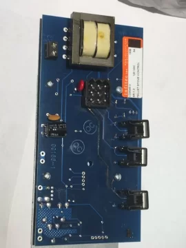

The Pelpro with the new Accutron IV control panel works with a t-stat
See t-stat screw terminals in upper left on back of control panel.
  • [Hearth.com] Englander questions
