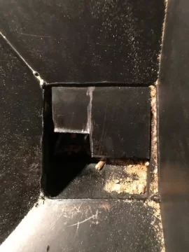

Keep hearing about an adjustable restrictor plate. Nothing on mine is adjustable and sometimes the pellets will will not feed down and it creates an empty spot and the stove goes out.

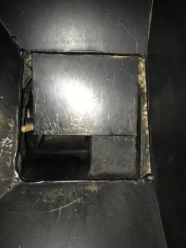

Doc, is this a question or a comment. There's been many a good threads over the years regarding this very issue. A quick search should get you going. Looking at the attachments, the welds in the second photo don't look quite right.
Reactions: BackDoc
i was thinking the same thing. sombodys been in there and modded the opening with a plate and painted the hopper.[Hearth.com] Englander restrictor plate?

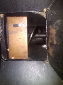

Somebody took the original restrictor plate out and epoxied this in there . Was this stove bought new ? The pic of the plate with the screw is what it should be .Maby someone broke the screu and did a quick fix ?
It was a question. I agree seems to be a home job modification. I bought the stove used for next to nothing. It has served me well last year and this so far. It does starve itself out once in a while if I am forced to use certain pellets. It likes Lignetics Gold the best but I can't get them right now. I am running Ultras which are soft wood and it will go out on occasion. It seems to be welded not epoxied. I may take the hopper off in the spring and cut a section of the plate off.
I am not really sure. Ssyko usually has the most knowledge on this forum concerning Englanders. Do you have a picture of the inlet on your stove?
A lot of the older Englander pdv stoves do not have the adjustable restriction plate
Reactions: BackDoc
Are the plates a standard part of the 25-PVDC? My 2003 does not have that plate installed.
My 2001 doesn't have one either. I usually like not having one in mine, but this year I'm burning Turman and they are smaller then most and feed like crazy into the top auger. (super hot fire). Almost wish I did have one this year.

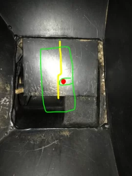

Are you sure its welded? It looks like it connects to the auger housing and that is cast. I would cut it as close to the housing as yoy can, but leave just enough to get a screw into the base. Watch the length of the screw don’t want it to connect with the auger
Cut - yellow
New position - green
Screw - red

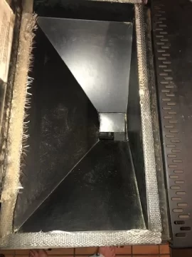

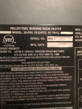

So I went home last night and was going to try to alter the restrictor plate however my wife topped the hopper off just before I got home. It was 3 degrees last night and I figured that would not be the best time to go messing around with it. My stove was manufactured 8/2004 and I am convinced this plate is factory. The hopper has not been repainted and the restrictor plate is not home made looking. The pellets pictured are what is giving me a hard time. I am going to wait for this cold snap to pass (50's by Sunday) and attempt to make the restrictor plate adjustable. It is not attached to the auger housing but to the hopper itself. My thought was to cut the plate across leaving enough room to drill a hole for a set screw and put an oblong hole in the piece I cut off to use as an adjustable plate. I am hoping Ssyko chimes in with some input.

I dont think so. Ssyko stated that 04 and prior Englander did not use the restrictor plate that you have pictured. It looks like it is from the factory. I wont know for sure until I pull the hopper off and I am not doing that until the burn season is over.

This is exactly what I was thinking. Thanks, I just realized you attached photos with instructions. You are the man. Thanks again.
