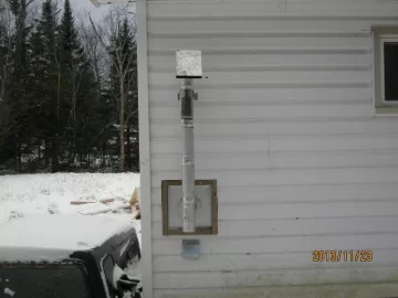

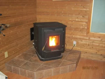

i finished installing my pellet stove today and got it fired up! what a pain in the butt! definitely not something the average home owner can do on there own and out in a blizzard -20 below with wind chill. i used the simpson dura vent pipes and i caulked and used a weatherproof foil tape on the joints with no leaks so far. i also bought a bag of premium michigan wood pellets and seems to be burning nicely. monday morning i'll be calling the inspector and then my home insurance company. once things warm up im going to cap the wood around the outside thimble and put a J mold around the siding to clean it up. anybody see any issues with that? and im also looking around to find some kind of stone to go on the back wall and then i'll build a mantle

Congratulations,
Looks great, I'm sure you will be happy with the stove and their customer service if you have issues, mike the head tech at ESW is on this forum daily so if you have issues or questions post them here and I'm sure he will jump in.
I know you have to finish the outside, but by looking at your outside pics you need to seal up your thimble area with heat resistant silicone, It looks like a few gaps on this end. Enjoy and stay warm. Also it does not look like you have a surge protector on that stove get a good one asap ya never know.

i caulked the inside around pipe and the thimble, so i should caulk around the outside of the pipe and the thimble?
Never let the cold in, or you will have to burn like the devil to keep it out. Wish I could remember who made that quote.
i went out this evening and caulked around the pipe so now the thimble is sealed on both sides. you'd think there would be a better way like the pipe would lock into the thimble.
Not that I know of, when you pull the stove out for cleaning and hook it back up the pipe will move slightly this may crack or undo the caulk job you did around the pipe just keep a eye on it., I'm sure you can use a tiny L bracket and attach it to the thimble with small sheet metal screws.. I did not do that yet.

Just a reminder, don't forget to get a surge protector today! Don't get a $5 cheapie either, get something good, I would try to stay away from those white inexpensive surge power strips also. But then again something is better than nothing.
Also when you get sick of dumping a 40lb bag in your hopper every 12 hours I would look into a hopper extension, (see my avatar) not the prettiest thing in the world but stops you worrying about waking up or coming home to a cold house.
