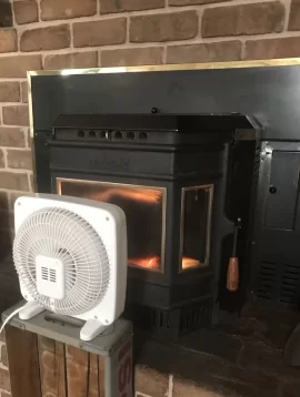

I bought a 70's split level home that came with an older Whitfield Advantage pellet stove that had been badly neglected. Took it all apart to clean it, replaced the firebrick and door gasket and have it humming along nicely apart from the occasional firepot overload.
My question has to do with increasing the heat output or actual thermal efficiency. I recently placed a small fan directly in front of the stove on a level slightly below the stove and pointing at the door glass. Theory is that it'll wick away more heat from the stove than if I rely on the internal blower alone. Thoughts on this or is it a futile waste of time?

You would probably get a lil more of the radiant heat if you had that fan on the floor 10’ from the stove to create more air movement in the room. slow air circulation. Also you should not be seeing any pellets building up in the pot if you have the flame set correctly and the air path through the stove is actually clean.

Thank you for that suggestion and I will certainly give that a try. The pellet buildup in the firepot only happens very occasionally and I'm trying to get a handle on the conditions at hand when it happens (amount of pellets in hopper, rapid change in barometric pressure, something...). Changing damper position seems to have no effect.
