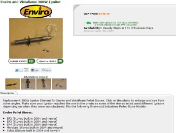

However if you are really ambitious, you can buy a heater cartridge and if the case or housing on the ignitor is still good. You can pull the heating element and install a cartridge for $21.00 by drilling 3 holes on the side and using some screws as set screws, holding the cartridge in the middle of the case by equally tightening the screws. Like the lamp shades on a ceiling light.
See Igniter Heaven Post
https://www.hearth.com/talk/threads/78371/
PS. Fishing the igniter wires thru the holes in the stove frame is a real PITA but I used a metal coat hanger and that worked out great!!
See pic below.
