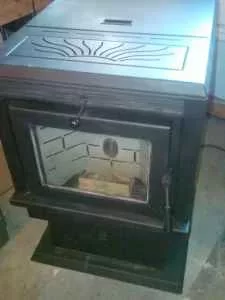

I rebuilt an EF2i Free Standing a couple of months ago. Very easy to work on and easy to get parts for. These stoves made by Sherwood Industries Ltd in Canada http://www.enviro.com/ for 10 years are very easy to get parts for. In fact I called their toll free number and asked for parts, the parts man was not only very knowledgeable but also very kind and courteous as well!
The stoves are really built strong and will last many years. Good luck
There is only one small issue I had you may want to check.
Enviro EF2 Heat Exchanger Tubes Cleaning Rod Sticks - Found reason and Fix for 0.14 Cents!!!
https://www.hearth.com/talk/threads/80566/
Below are a couple of my pics.
  • [Hearth.com] Enviro EF2I Insert Coming
