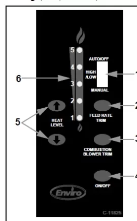

If you have the newer control board, then you can only have two possible problems - the fan needs oiling or it needs to be replaced. The newer control board looks like this:
[Hearth.com] Enviro empress fs
The older board only has ON/OFF and heat level. The older board has become famous among knowledgeable techs for ruining convection blowers. And the symptoms are EXACTLY what you describe. Fan won't start, or hums/vibrates loudly until you turn the heat way up.
I was changing blowers at the rate of one every couple years until Don showed me that I needed to change the control board. Ouch, for the cash outlay, but the stove works the way it was designed to do, now. And it's quiet(er) and reliable.
Hope that helps.

Well thanks for the reply. I have a newer control board that looks like that. But the convection fan/motor is not like that. It's the one that someone described as a "squirrelly cage". Tonight I shut it down took out control board, checked out all wiring connections,checked and cleaned vacuum hose then took out convection fan(again). When spinning fan by hand it didn't seem to be spinning as free as I thought it should(spin about 1 1/2 times then stop. Also when in stove I could hear the squeak on the non motor end. And since there are no oil ports on this kind I delicately put a drop of pb blaster at end and stood on end for bit to soak in(and make sure al residue and vapors went away so as to not create a fire hazard) after that it spun much more freely. Then I put back together and it seems to be working fine now and no squeak(knock on wood). My logic seems that at low speeds it was dragging to much and didn't get enough juice to spin and only work when output was turned up and more juice to spin it! Hopefully it it will get me thru the winter and then I can look more into replacing the fan.
