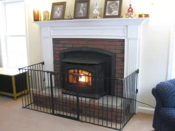

I just installed mine today and it's been running for about 10 hours. I did lots of research on inserts and was having a hard time deciding between the Harmen Accentra and the M55C insert. I was able to find a stove shop that had both installed and running side by side and it only took me a few minutes to make my decision. The Enviro is much, much more quit and even though it may seem that the blower is not pushing out the air is hard, the M55C puts out 200cfm vs 180cfm for the Accentra and it is noticeable as the Enviro felt like it was pushing a lot more heat out. The Eviro is also 55,000btu vs 42,000btu for the Accentra.
So far I am very pleased with the stove, the house is a nice warm 70 downstairs and around 67 upstairs. It has been a warmer day today though, about 40 out, so the real test will be when the temp gets down in the teens. I'm heating about 2,000sq/ft.

Looks really nice!!! I like the way you 'kid proofed' it! What did you use?
I'm sure everyone will ask you if there is a surge protector on the other end of that power cord. :) I have 'The Energy Detective' installed in my house and we had two spikes today of 146.1 Volts! It stays pretty steady around 118 to 122. This was the second time I've seen this in the last 3 weeks. I have APC constant voltage transformers on mine plus my entertainment equipment.

Thanks for compliment! The safety gate is the KidCo HearthGate. Very easy to install and very sturdy. My 21 month old climbs all over it (mostly to test Mom and Dad) and it barely moves.
I don't have a surge protector hooked up yet, shame on me I know, but I am going to install a dedicated circuit for the stove with surge protection built in. Leviton makes a few variations. When Holms on Homes used to be aired here in the States I saw that he would install a whole house surge protector right in the panel. I'm going to look at doing that as well, that way everything in the house is protected. I currently have a Monster Cable surge protector for my home theater system.

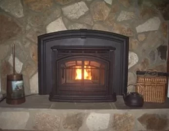

Have had mine since November. Love it. It's quiet, keeps the house nice and warm.
