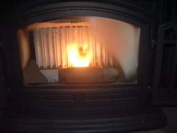

Apparently it's an Enviro thing. Here's a picture of my M55 insert

RM - I would suggest contacting the manufacturer to see if it’s on their radar. We have an M55, the soot appears on the glass...for us it’s really not a problem. We clean it weekly and enjoy the heat.
I would ask that some of more experienced folks here…I believe soot on the glass is common amongst many manufacturers to a certain degree.

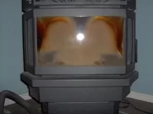

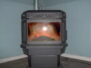

Attached is 3 pic's of my stove after 5 days. I couldn't be happier compare to other stoves I have owned. Notice the clumps of ash stuck on the baffle! These are O'malleys burning which were below average overall. I get much cleaner glass with cleaner burning pellets.

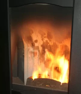

It isn't an issue with the stove at all.
You can not burn wood and not have residue deposited somewhere.
The residue is going to deposit on all surfaces.
What gets deposited where is a function of temperature at each location and how much air flow there is to stop larger particles from landing in the residue.
I'll resize some nice long low burn pictures later tonight and post them.
Mine does the same exact thing, but I can live with it. As j-takeman said, other manufacturers are far worse. The glass on my quad stays clean as long as it's not running!

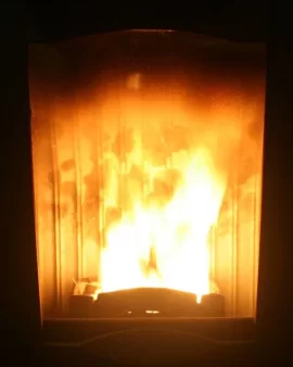

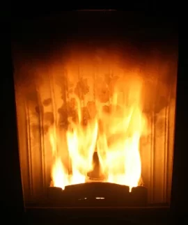

Let's see how this comes out the lower numbered picture was after 23 bags over 26 days the higher number picture was at the one ton mark the glass was not cleaned, what changed was the firing rate.
