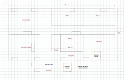

Everything is set and running but I'm not exactly sure how I should duct this thing.
Should I tie into the existing ductwork? (Return air or Heat side?)
Should I cut in new registers?
Attached is a picture of my house and how it is currently ducted. Any input would be greatly appreciated.
Thanks!

I have looked at the manual and it does recommend just to connect to 2 registers,
I'll have to call the inspector and see if I would be able to tie into my air return.
Ideally I would like to tie into my air return ducting, seal those ducts off from the existing furnace and then open the
return air plenum (is 6' from my pellet stove) and use it to distribute the radiant heat from the stove around the house.
Not sure if that is feasible...or up to code.
