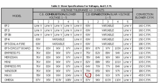

Actually the stove has such a large convection blower the controller is programmed to turn the convection blower completely off at low fire(once stat has reached temp). Voltage to the fan goes to zero volts. Perfectly normal. The convection tubes are very large on these units and will radiate plenty of heat without adding convection air. Plus the blower is so large even running it at the minimum voltage it could run at would force enough air thru on low that the air would be almost cold.
See the chart I posted It has 0 as the voltage supplied to the convection blower on low.
