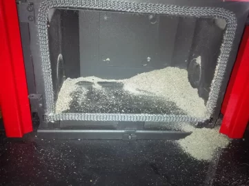

Second, who designed this ash pan? Stupid thing doesn't fit snug and there are ashes everywhere when you go to clean it. As a result, we now put it off until we really need to empty it and have a special scoop to collect all the ash that has fallen outside the pan. Bright side is it usually lasts a week in mid winter. See photo uploaded on this post for what it looks like everytime you pull the ash pan.

  • [Hearth.com] Enviro P3
