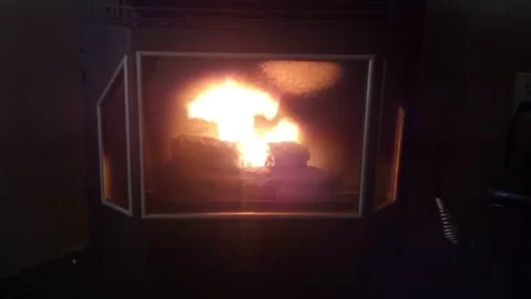

Just wanted to insert a picture of my flame height at heat setting 3.
Bottom buttons are at 1-4-1.
Is that flame what you get AFTER the initial start-up pellets? If that's what it looks like during a "normal" burn (after about 20-25 minutes of burning), then something is wrong....that flame is WAY too high.
That was taken after about 8 hours of burn time.
Yes.....x2.......not to be "Captain Obvious" again but it definitely looks as though too many pellets are being fed into the pot. Does it do this when you have your heat setting on 1 or 2? What pellets are you using? Are they very small?

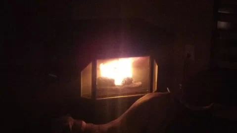

The flame is much lower when done on setting two, but I'm not getting the heat I need. I'm burning Cubex. Here is a new photo. Heat setting 4.
You can see how black the glass has gotten. This is less than 24 hours of run time. I believe the issue is with over feeding. My burn pot is about 3/4 full and I emptied it out last night around 1030. The stove was run at heat setting 2 over night. Kept my first level at 70 and my bedroom upstairs at 65. I need it just a bit warmer. Low last night was around 20 degrees.

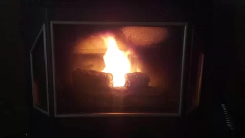

Heat setting 2. I gave it some time to burn off whatever it dispensed from heat setting 4. Flame is lower but still crests the top of the fake log set.

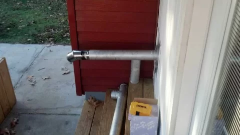

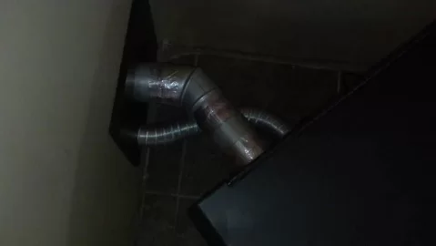

Here's a couple images of the vent setup. And 300 dollars of extra venting.
