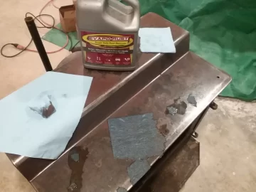

Have a ginormous Vestal that needs a quick clean and paint. Replacing with Baby Bear. The top has some pitted patches as if a cute little cast iron tea pot or other nonsense was left to sit on it wet. After scuffing with a DA sander I layed on some shop towels wetted with EvapoRust. Keep it wet ans itll keep working. Should cover with plastic like saran wrap but thats in the house and the beer is out here in the shop.
