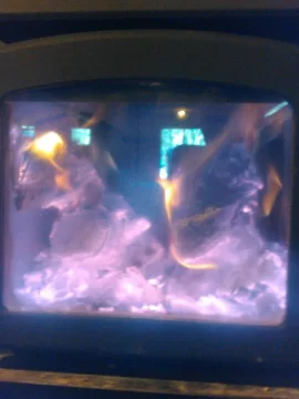

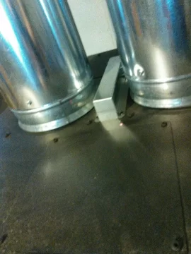

Here is a picture of the video. This is back side of burn no strong flames, no more nice secondary burn going on. Mostly logs are about to brake up in larger coal chunks. The second picture of the top ( see red dot in middle ) is to show where i took the temp reading. Its 130*-135*.
