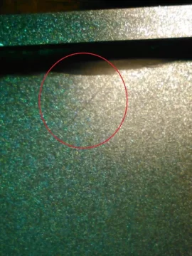

And the plot thickens. So today i stopped by a good friend of mines house. He too has a Drolet wood stove not a furnace. As we were talking i asked him for a flashlight. You guessed it i started looking around. Took about 2 seconds before i found the cracks on the front face. This will be his 3rd year using the stove so i have no idea when they happened. Wait a minute aren't these tundras cracking because us dumb asses don't have them installed right????
So let me guess he doesn't have his wood stove installed correctly. Last i checked he had his stove venting out the chimney. I found this interesting so i figured i would mention it here. Here are some pictures. 2 cracks above the door on each side. You can see Drolet etched in the glass on the lower left hand corner.
View attachment 172479 View attachment 172481 View attachment 172477
