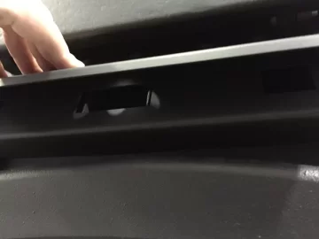

That said thanks to brenndatomu for the information on this thread and also the heads up on the Tundra Sale. I purchased the Tundra yesterday.... Serial Number 734. It looks to have had the air intake modification done.. The center holes were larger than the two side holes and it didn't have a the after thought clip on plate installed. It didn't have the firebrick for the front... Anyways they are ordering one for me and it will be a few weeks before it is in....So a $300 rebate and another 2% rebate with using my Menards card and getting rid of about $150 in menards rebates.... I am excited about buying the rest of the toys to make this new tundra run like my regency insert but with a larger heating capacity....

Crewchief, Tundra is hard to pass up at that price. The only question i have is did you have the option of having them order a new one with all the revisions? I believe what is going to save the new ones from cracking is the fact that the front face and heat exchanger are no longer welded together on new models. Also the firebrick they end up sending for the front face is junk. Its soft stuff and gets beat up bad loading and moving the wood around. Cutting an angle iron to cover the edge of the firebrick would be best. Mine were finished by seasons end. The top baffle cracked down the middle on mine and i am going to us that to make the firebricks for the front face this year. The guys on here are first class when it comes to helping someone out so ask away if you have any questions.

I can't tell looking at your first picture...Does the bottom of the heat exchanger have tack welds to the front face?

You have it already or they had to order one for you...I'm not sure I follow you? Was it a display model? The display model at out local Menards has been there for 2-3 years. What is the build date?
