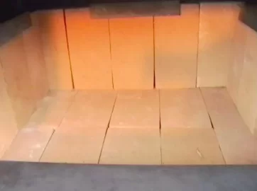

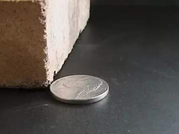

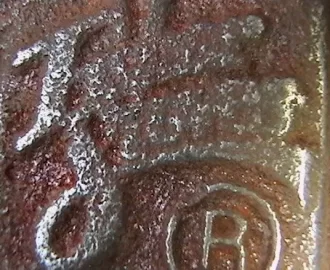

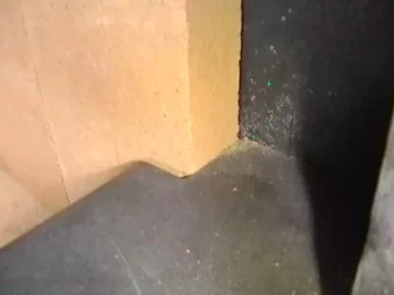

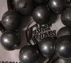

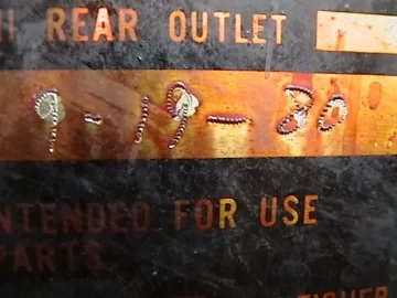

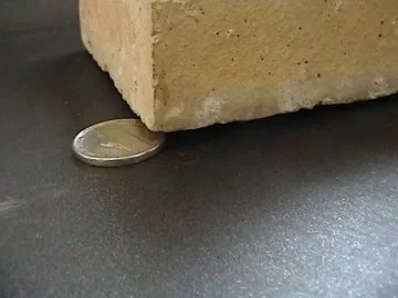

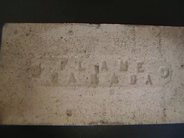

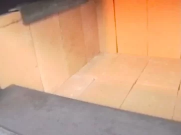

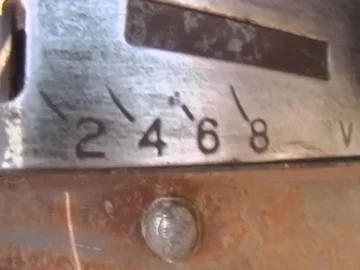

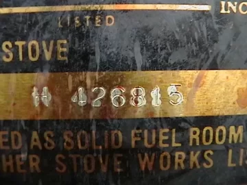

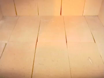

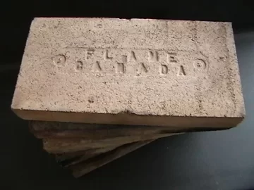

Pics... refractory brick 'flame canada', flat, very uniform, quality.Typical neat Fisher thought...screen handle labled with arrow, up closed or turn to left to open.
  • [Hearth.com] Everything Fisher

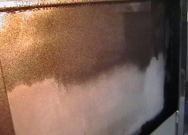

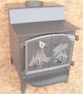

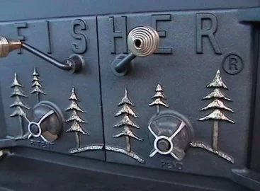

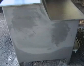

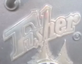

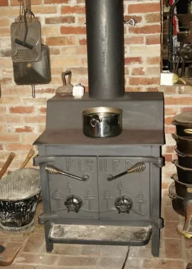

Beware of Bears :-) . Many stoves I restore reveal a red oxide looking primer under finish, SB's primer is proving well....gives a nice base and even deep finish.

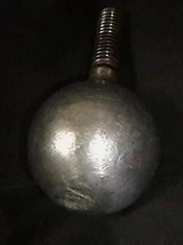

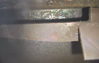

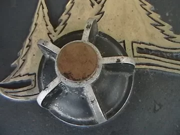

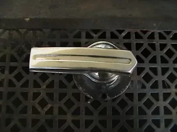

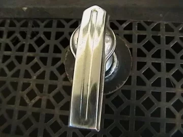

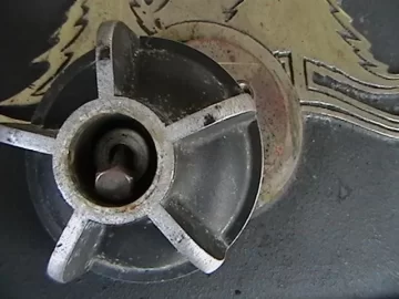

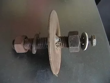

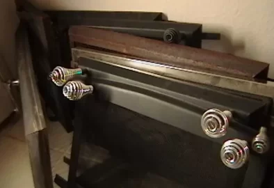

just parts n pieces.

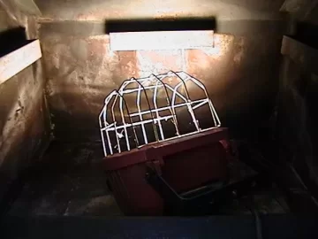

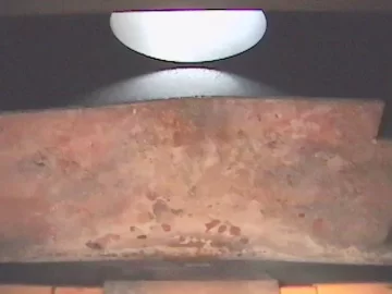

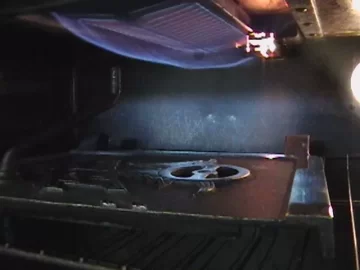

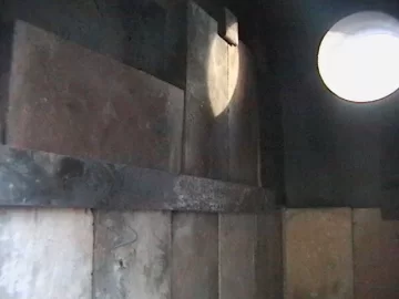

One of the many nice details of restoring a Fisher to original or as near to oem as possible is the fire bricks. CBI group, Abbotsford BC Canada manufactured and supplied refractory bricks one finds in alot of original Fisher stoves. They are far better in quality, from size and uniformity, even psi strength. Bricks are labeled 'Flame Canada' on the face from casting mold. Clayburn no longer manufactures thier own refractory bricks, rather they 'import' from another source unfortunately. The originals sit so nice and flat not only creating a nice floor, but the side walls are tighter as flat as well. The new style fire bricks are VERY irregualr, in every way. ....either they are cupped up and can rock and break and have lips to catch your ash shovel, or air gap under which can also break when any log...especially heavy hardwoods are tossed on them. Pic shows flat and nice original style brick. Other pics show the warp, coins placed for illustration. what seems to work for me, may not work for another though, said with consideration.

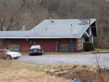

Oh My is right.
Wait 'till you see what's behind the blue door;

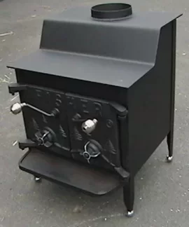

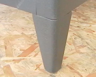

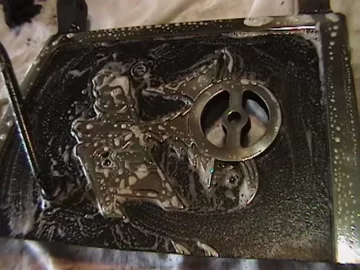

Heres the more of the process. Its no perfect restoration or time involved stove, none the less, its clean for use and look nice in a home. Its fun and enjoyable, you get to see the transformation bringing a stove back from years of use, then you as well can enjoy a good looking stove and the great heat.

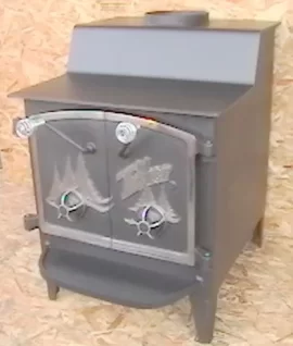

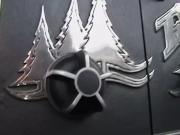

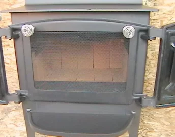

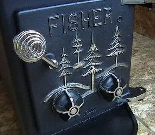

Heres the Grandma III ready for service, screen as well. This stove has the neat pillar cast iron bolt on legs too. The board is neat with all the generations of Fisher stoves, made in U.S.A, classy stoves with excellent performance, thought of and built by an innovative guy!!

Mama Bear, grandma and grandpa headed out to new homes today. Guy named Rich is also looking into a papa bear. Grandpa with baro on rear, square doored, nickeled ball feet (rest) adjustable. Square doored mama bear with bear paws.

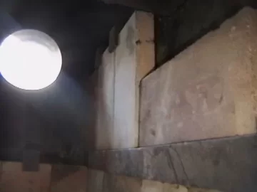

Working on early Papa Bear that just came in. Great original condition, has bricks lined on floor and sides, bricks aboves first side row of bricks as well...and it is original factory, will get pics soon. Lots of great stoves out there to be picked up, looking and hunting is just as fun as making them as new!. Last Grandpa had original baro on back, sweet stove.

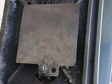

In working with the insert, it seems that the flue damper is just loose in place, hanging wide open (I assume). As part of the steel surround around the insert, on the right side, is what appears to be similar to a keyhole, and I'm curious if this was some sort of slot for a damper controller, a chain or mechanism? Its just below the horizontal level plane of the top plate. Its a round hole at the top, with a slot below it, connected to the hole; quite similar to the classic skeleton keyhole in its appearance - but there is nothing in it (that I can see outwardly), just an empty slot.

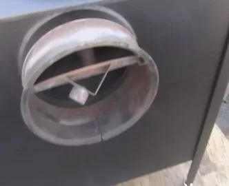

Should be a flat 1/4" x 1 1/4" x 18" piece of flat bar stock with a spring that matches your doors on the outside end and a hole punched thru it on the far end that connects to the flue.... The bar should be notched on the bottom so you can lock in the flue to the position you want it..
T
If you are missing this piece, PM me & I will send this to you. We have an extra one of these damper control bars from our other fisher insert that was sold off years ago to be used as a free standing unit in a shop. The spring handle is missing though
