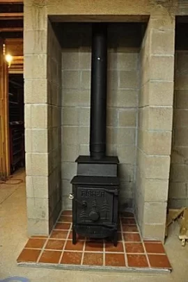

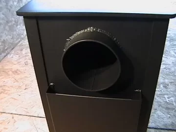

The only reason they became so popular is that they don't stick into the room as far as a Mama or Papa. They had to have an 8 inch flue to be able to run with the doors open. The novelty of the wide open view of the fire wore off quick when you don't get much heat out of them , and they burn like crazy that way. Square inch size of fire box and square inch heating surface is the same or less than a Papa, and the 6 inch flue on that worked just fine.
So many people thought, since they could stick one back in their hearth, they should buy a top vent and go straight up. I'm sure the salesmen told them they needed a rear or side flue for that installation, but the customer didn't want the stove sticking out into the room. Can't have an efficient heater and bury it into your fireplace either...............
Best installation to me is in the middle of the room for better circulation, and no clearance problems. A section of pipe straight up with the damper, then adjustable elbow to pitch upwards to a hole higher up in the chimney. The horizontal run doesn't kill the draft that much, and takes advantage of all that surface area of the pipe on the way out. I built my own house with a Dura-Vent chimney support box in the center of a big kitchen, and a chimney in the center of the living room. I have an old piano mover that is a low steel frame on wheels that goes right under a piano or stove. lifts it a bit, and roll it right out. That way it's no big deal to use an antique parlor stove fall and spring, for a little heat, and the Fisher of my choice for the winter. I lean towards the Goldilocks since it's square and doesn't take up much room. It also has a double heat shield on the back that directs the heat off the back straight up. I face the back of the stove towards the fridge to keep that part of the house the coolest. It used to be an ice box, but the rest of the family couldn't deal with my Amish tendencies so she's parked in the corner in case the power goes out. Will they ever learn?

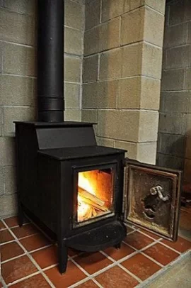

One of the other club members put a new gasket on and the doors are hard to close. but when I was there during deer season the corner was coming loose, Is it better to remove the gasket completely, I may been contacting you in the future, we plan on doing some work on it in the summer.
I would remove the gasket and clean up the channels. The stove was designed to bypass a gasket all together.

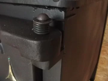

Worn hinge pins will prevent the door from closing flat and exactly perpendicular to the channel too. I take my pins out each year and grease with high temp grease. I was in the propane business, and have gas valve grease which is super high temp stuff and lasts an entire season. It's gray, thick, and stays put. Otherwise regular black moly grease is OK. Hang on to that door after you grease it if your not used to a door that flys open !
Prevent the wear in the door hole, and stove hinge plate, and it will stay tighter. For most it's too late. Once the hole is elongated, we're back to machine shop to ream it round again, and go to a larger size rivet. (pin)

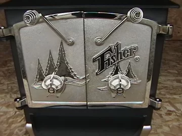

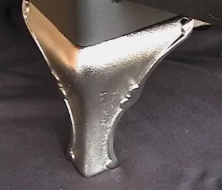

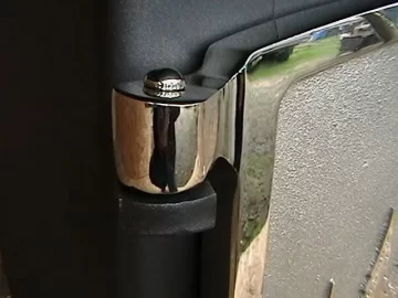

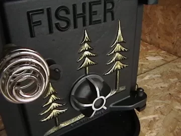

Ok maybe coaly can help me out on this one. My Fisher is in pretty rough shape and I wanna basically restore it to as close to like new as possible. I am planning a good once over with the wire brush and then a coat of rutland stove polish. Am I thinking along the right lines? Can the chrome ball feet be replaced or refurbished some how? Also are there replacement handle springs available somewhere as the plating is chipped off mine with the years of use. I don't want to turn it into a museum quality piece but don't want it to look like a pile of rusted up scrap iron either.
Regarding the chrome feet, call around and you can probably find someone who will rechrome them for you. My sister found a guy who will do piecework chroming on just about anything for cheap. He did some bicycle parts for her and the hubs to our childhood red rider wagon.
Coaly, I suppose you are acquainted with this guy?
(broken image removed)

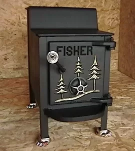

Guess you could say that. It was sold on eBay twice it's so nice !
Don't know what happened to your picture there Tick, but here it is;

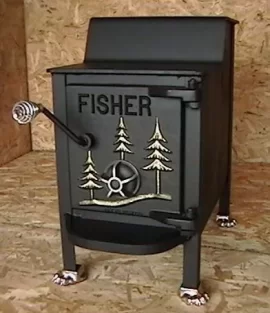

Here's a pic of the optional spring to prevent the door from opening too far on that same stove;
And a close up of the door.
  • [Hearth.com] Everything Fisher
Thats a beautiful restoration. Reminds me of the classic car restorations that are done so well they are nicer than when they rolled off the assembly line!

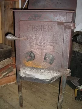

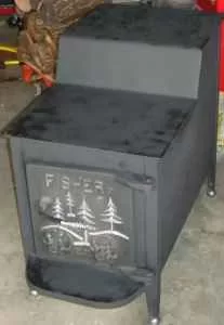

Whats the deal with the bear with the long legs? Was that normal?
That's one tall Mama.
(2 draft caps) I read somewhere about someone with a bad back that raised their stove to prevent bending to load it.
